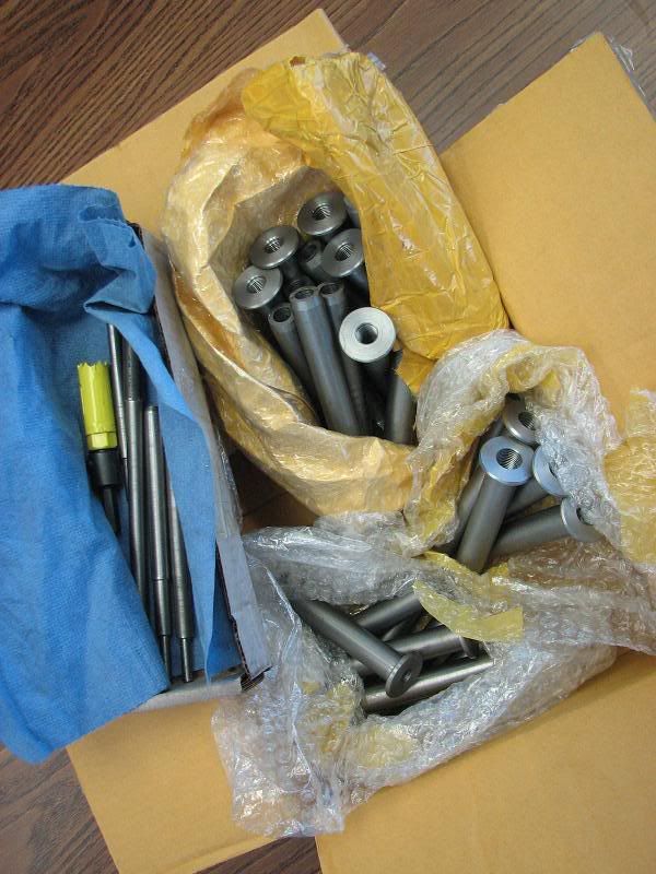

Make your you say "yes" when he asks if you want the 'install tools'.
Post 99 has a photo breakdown:
http://www.dirtyimpreza.com/forums/showthread.php?t=8553&page=7
Re: Rolling my car...
January 10, 2010 09:34PM
So why do they stick out so far? Or do you cut them down?
January 10, 2010 09:37PM
If I decide to build an 'x' between the strut towers I will tie them into it. That's why they are still long. I cut the rest.

I foresee a serious bobbin addiction in my future!
January 11, 2010 01:37PM
Where do you buy these bobbins?
January 11, 2010 01:45PM
apromachining.com
Tibor is super nice, gets work done quick, and at very reasonable pricing.

Just ordered bobbins. The addiction begins!!!
January 12, 2010 10:08AM
He's not kidding. You want a drill that geos SLOW...
I bought a $50 Mastercrap 1/2". I just tap, tap, tap the trigger. The motor hates me but, I got 10 bobbins done and the bit is just as sharp as when I started.
I used "Gunk" penetrating oil for lubricant - I use it for all drilling - it worked perfectly. Just don't let it sit overnight after you drill out the rear subframe nuts... Fuck! So many layers of steel there and it seeped in making welding a hell of a chore.
It's firly easy to tie the rear suspension into the cage.

those bobbins are basically jus like a captured nut, only eight thousand percent better, correct?
Tied into the structure better, and with full thread engagement, so the bolt that goes in doesn't rust at the top and snap off right when you need to take it out?

How much do the bobbins cost?
Seems like it'd be just as easy and possibly cheaper to buy steel tubing with the right ID to tap to whatever size bolt, much like Lurch did for his rear trailing arms on the 3.
