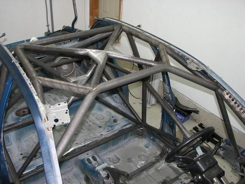

About 100 spot welds.
Get one of these:
http://buy1.snapon.com/catalog/item.asp?P65=&tool=&item_ID=15684&group_ID=951&store=snapon-store&dir=catalog
^^^ I got one of those for about $100 off the Snap-On truck. It has worked perfectly for about 400 spot welds on a single bit (3 standard size bits are included). And, I've used the other bits for odd projects (3 larger sizes included).
Drill really, really slowly and the metal stays soft as well as the bit staying sharp. I think my drill runs at about 100rpm. Some spot welds are easier to drill from the bottom (if your cage isn't in the way) most are easy to drill from the top.
In' my picture above the front and rear cross braces are removed. If you're just replacing the skin, you'll want to leave them... add another ~30 spot welds to drill smiling smiley
I use "GunK", the penetrating oil in a yellow spray can. It works well as a lubricant, it's cheap, and it sticks to the bit.

I noticed on my car the rain rails were so smooth it was impossible to see the welds. did you have to grind away all the seam sealer to get down to the welds?
I have to keep all the cross braces for the new one to mount back to. Funny thing is ive only been able to find pictures of the RS's doing roof skins not a single GD or 02-07 Impreza.

If I remember your car correctly, you've only got a half cage... Be vary, very carfull. The roff may not be very stong, but it ceeps your entire car 'squared up'. Tack your cage to the c-pillars if possible, don't let things twist.
All that being said, mine's a GC and there are sheet metal thickness differences...
Re: Roof Skin GD Impreza
February 12, 2010 04:36PM
In fact, don't even think about removing the old roof skin until you have the entire cage welded as much as you can reach with the roof on. You can zap the spots you couldn't reach on the top of the cage (if you didn't do the drop it down, weld the top then shove it back up and weld the floor plates in last method) when you take the roof skin off. But if you remove the roof skin and then start welding up the cage (especially if you are tying it into the roof, pillars, etc, like you should) youl will find that the new roof skin won't fit properly anymore.
