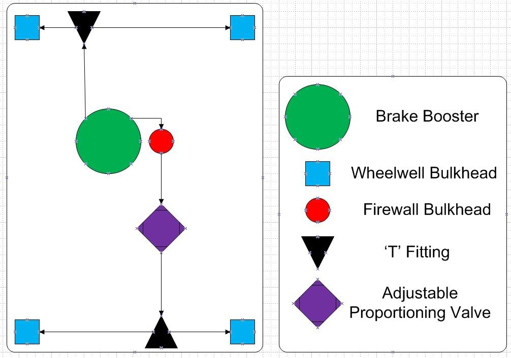

So there are lots of threads on this, but none of them spell out the basics to someone like me who has never done this.
I'd like to redo all of the lines in my car. The old ones are junk. I've read about all the (fancy) AN fittings and braided lines, but I'm trying to keep it simple.
Id like to run hardlines from the booster to the wheelwells.
I'm not running a hydraulic handbrake.
I have a brand new set and a spare set of braided brake lines for OEM subarus and I'd like to be able to use them.
I'm also planing to use an OEM booster.
I think this illustrates everything I need:
I will need to pruchase all of the tools as well, so any suggestions would be great. I've heard that this is not a place to skimp on tool quality.
The car I co-drive for has hardlines that could be bent by hand... That's not a concern to me but, they are also more corrosion resistant than 'standard' hard lines. My Driver can no longer remember what brand of lines they were, but he said they are holding up far better than the last lines he ran. Any idea what they might be?
I'm totally new to this and have no idea about the different threads and fitting sizes. I've seen the AN-3 lines and the NPT fittings, but I'm not sure what the benefit is of one style over the other. I also don't know what style of fitting I'll need to match up with the OEM style lines and the OEM brake booster.
Car is a Subaru.
As for the bulkhead fittings, I was figuring I'd use 90degree fittings at the wheelwells and the firewall.
Thanks for any help, suggestions, oppinions, or links you can provide!

I forgot that I'd like to use an adjustable proportioning valve as well...

did you toss all the OEM lines?
Use as much of them as you possibly can.
Then are cleaner, and tighter fitting can you will ever be able to do.
It honestly is a bit of an art, and takes practice to make the lines.
it's one of those jobs that you start out saying, "man i'm gonna make these things so nice, and fitting well" then you get all done and they are ugly!

+ 1 on keeping as much of the original lines as possible.
I removed almost all of them on my laser, tried my best to do some nice looking new ones, but after a few days I called a friend and ended up getting the original lines from his part car.

There IS a gernerally good priciple that save money, saves time and works good: add and mod what you need to.
I have never understood the "rip everything out" and then re-do 85% the same as it just was mentality.

Thats hoping that they're not going with the loony idea of putting -3 braided or even worse -4. But the reason to rip it all out is to maybe re-route them inside the car cabin.

February 23, 2010 02:58PM
I did not throw away a single thing. I still have all the original parts.
I was concerned with the lines to the front calipers as they had been abused when the rubber lines were changed at one point in time before I purchased the car. They (the hard lines) had visable twisting and corrosion as well as the nuts were quite rounded before I got to them - flare nut wrenches were not used before I got to them.
I'm changing the entire caliper setup to a mixmatched set of calipers from two other models of subarus (early usdm WRX in the rear and '02 RS up front). I know how to play with the brake pads to achive a balace that I like using those calipers from my experience with another of my toys. But I don't want to steal that system away from that other car. So, I'll be left with an OEM proportioning valve that was meant for the smallest calipers that were sold on an impreza (13" wheels clear them) and Drums in the rear. I'm not sure how that would work.
Also, and I'll have to confirm that it was this way on this car, but I thought that the lines were setup with the 'x' patern distribution.
Another issue is that this car came with the hill holder assist which I will not put back into the car.
I have sil bars on this cage and a lateral tube between the bases of my main hoop 'x'. I also have the front strut towers tied in to the cage and they are all in the way of the OEM lines as they run across the firewall, not to mention inside the cabin under the dash where the OEM lines run at the co-driver's feet and across the rocker, up the rear seat area.
I understand the idea of not fixing things until they are broken. But, I'm learning the long way (and the fun way - for me at least) how when you make a small change in one system... it ripples.
All in all, I'm confident, but I will confirm, that altering the OEM system will take just as much time/effort as starting fresh.
As for bending the tubing, I was raised by a Plumber (coolest Grandfather ever!). I've got a fairly good understanding of stretch ratios and the difference between the length of tubing before and after you bend it.
I do fully accept that I know very little in this area though. If you all still think it makes more sense to stick with th OEM system, let me know. If not, I'm not going to cry over spilled milk and worry about the extra time I'm spending now because of descisions I made a year ago.

Yeah, I was thinking of a single line run from the firewall, down the transmission tunnel through the rear seat area and "T'd" off between the rear wheel arches. Nothing to step on (unless the car is on it's side).

Subaru brake lines are already inside the car. You could always cut the stock lines back a few inches, do a new flared fitting on them, then use a longer piece of braided lines if it's just a problem in the wheel wells. Or you could grab a new set of stock stuff from a junkyard car that are in good shape.

I know where you are coming from.
My car had all the same junk, Hil holder included.
Up until July of this year, i had the hil-holder in my car, just unhooked it so that it didn't do anything (disconnect the cable).
The brake set-up you are going to use is not oddball at all.
WRX rear calipers are the same brakes as any other rear disc impreza or legacy. Same as 2.5rs etc.
The fronts....they use the same calipers, but different brackets to work with the smaller rotors.
I have the "stock" Subaru Prop valve sitting in my garage if you want to use it. I used it on my car and it worked just fine...assuming i can find it!
Getting the OEM lines to clear the cage sill bars is much easier than you think.
If the "tube nuts" on your OEM lines are rounded off a bit and seen better days. Then chop off the flare, slide off the old nut, Slide on a new one, and reflare the end.
However.. if you decide to make lines...i have had good luck just going to the AutoParts store and buying 3/16" hard line by the 25 foot roll.
I try to reuse as many of the OEM tube nuts as you can, if they are in good shape, chop the line and reuse it.
PROPER metric tube nuts are very difficult to find in this area. Same with all metric fittings, Metric t-fittings for exampe are almost impossible to find.
The line doesn't rust, it bents fairly easily, is cheap, and works.
