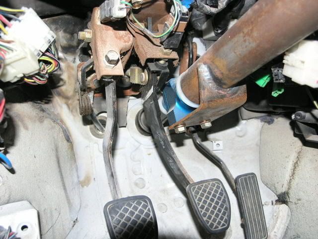

I'm using a coleman 1.5:1. three years of rallyx and one stage rally so far w/o issue. it will only collapse about an inch or so now.

Ooooh! pics even! thanks y'all

I have one in the suba-rat from L&E Fabrications. Its still collapsableability.
I then upgraded to a used STI steering rack. I'm now 1.75 turns lock to lock, its AWESOME. A little stiff in tight steering/parking situations, but on stage you can't even tell.
All on the stock steering pump w/no trouble to date.
Highly recommended.

I ran with one, I found no issues with the Colman, yes it did reduce the collapse of the column.
I think a good rack would be better if you can find on for you car, but if not it works well and I had no issues.
