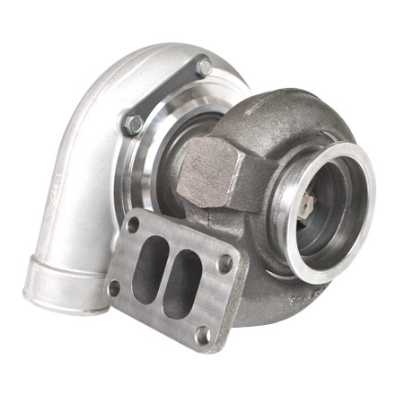

I've seen the GT2860RS with T3 exhaust housings before.
> before.
> Grant Hughes
> Denver, CO
Even better ATP now has a T3 twin scroll housing for even faster spooling if you make a proper manifold for it.
http://www.atpturbo.com/mm5/merchant.mvc?Screen=PROD&Store_Code=tp&Product_Code=ATP-HSG-102&Category_Code=GTH
Edited 2 time(s). Last edit at 05/03/2010 06:11PM by Tim Taylor.

Tim Taylor Wrote:
> housings
> > before.
> > Grant Hughes
> > www.nocoastmotorsports.net
> > Denver, CO
> manifold for it.
> Edited 2 times. Last edit at May 3, 2010 by Tim
> Taylor.
That's new! Cool, so you could swap between 2860,2871,2876 CHRAs w/ T04b compressor housings if they have 53.8(76 trim) wheels and use the same exhuast housing. That's really neat. You could have 60mm,71mm, and 76mm on the shelf if you were so inclined.
So the A/R on the exhuast side there on the twin scroll is .82, They also make .64 and .48 on the gt2871r but not twin scroll...
Though it is twin scroll it's got a large a/r ratio, so it would be interesting to see spool comparisons and the top end hp comparisons on the smaller A/R turbos without twin scroll.
