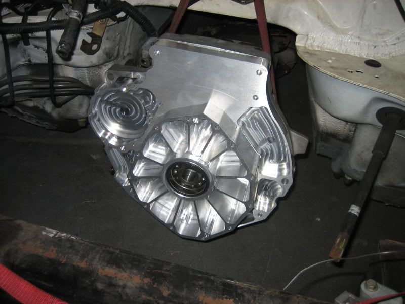

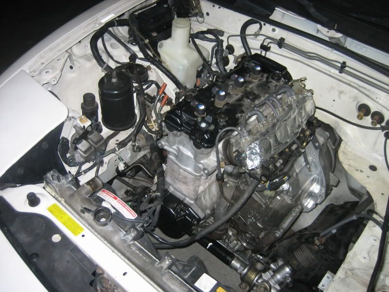

This has finally gotten far enough along that I think it applies here. I've been working on this for the last few months with Dave and another LeMons racer. The kit we're planing should let you drop a Hayabusa engine into basically any small front engine rear wheel drive car that's suitable for rally...like say a Starlet or a Kadett. We're doing the Miata first for Dave and I'm going to do a BMW 1600 next because I want something pre-SMOG so I can drive it on the street.

Internet reading comprehension for the loose. Crashed Hayabusas are a virtually limitless commodity and are fantastically lighter and more refined than any car engine until you are spending $20-30K on a dedicated race engine. Think for a moment about how much the engine in your Toyota cost to build, how much power you think it's going to make, how much it weighs, and then it will make sense.
I bought a crashed bike last month with 2326mi on it...we're parting the bike on eBay and the engine will end up costing less than $1200 when we're done.

Bike transmissions are simply not strong enough for car use. Even in 1400lb GSXR1300 powered Westfields the transmissions don't last more than a couple thousand miles without fragging. Not having a reverse gear is a colossal pain in anything other than a dedicated track car. On the gearing take another look at the first article Dave wrote and it will be explained.
