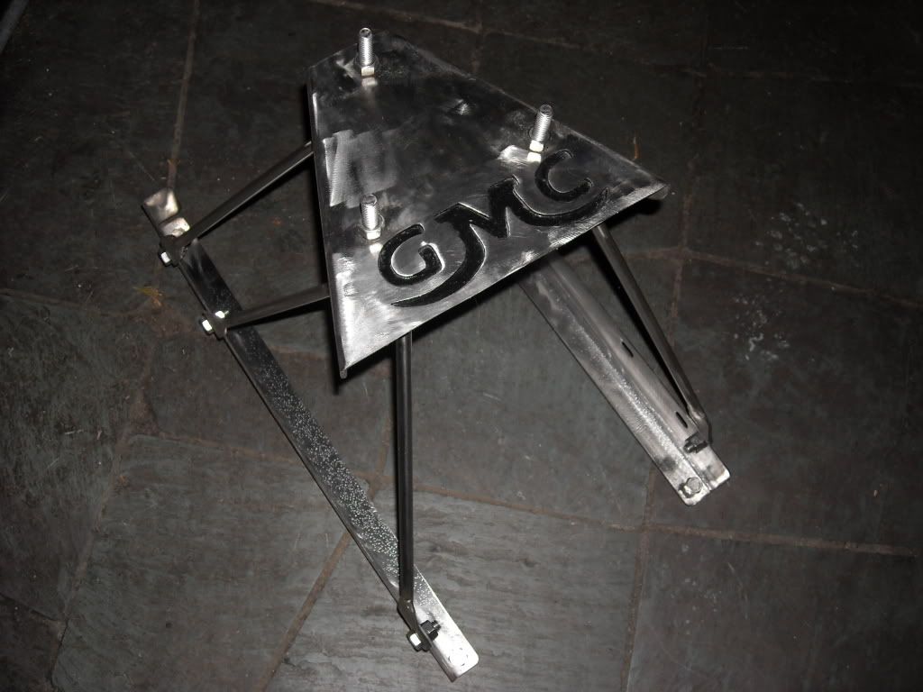

nitrogen is very good at preventing oxidation. copper oxidizes and becomes porous
and contaminated on my cutting tips.
ss will have a porous and black cut on the back with plasma and very little with
laser and no nitrogen.
I know of 3 shops that might do it one off what are you making?
this was cut with just air it cleaned up fine just you cant do directional grind
material because you have to clean the edges.
