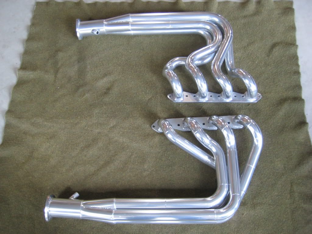

Evacuation systems that use the exhaust for vacuum at high rpm will put
oil in the exhaust, even with a AO seperator... An example of a nice set
of racing headers that will use crankcase evacuation...
The nipples in the collector gets a check valve, then hoses run up to the
AOS, which has a filter media inside it to hopefully catch most of the oil
fog, then has another pair of hoses to the front of the valve covers.
The system doesn't work very well at low rpm, only draws 1 or 2"hg,
but under load, at mid range and up, will pull upwards of 15"hg...
