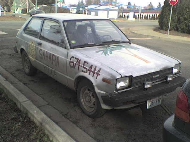

Hey Welcome!
I used a have a 82 Starlet...
From what I found when I owned mine was if you needed parts the price was high, and when you didn't NEED them you could fill your backyard with spare cars and parts for the price of the fender you bought when you needed it.
The clean starlets would bring good money, but mine had 270Kish miles and had been on the coast most of it's life. It had a lot of rust.
If you're going to build a starlet, find a nice rust free shell... and go with that. As Grant said, you're pretty much not going to keep anything stock except the body anyway.

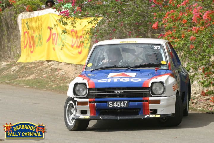

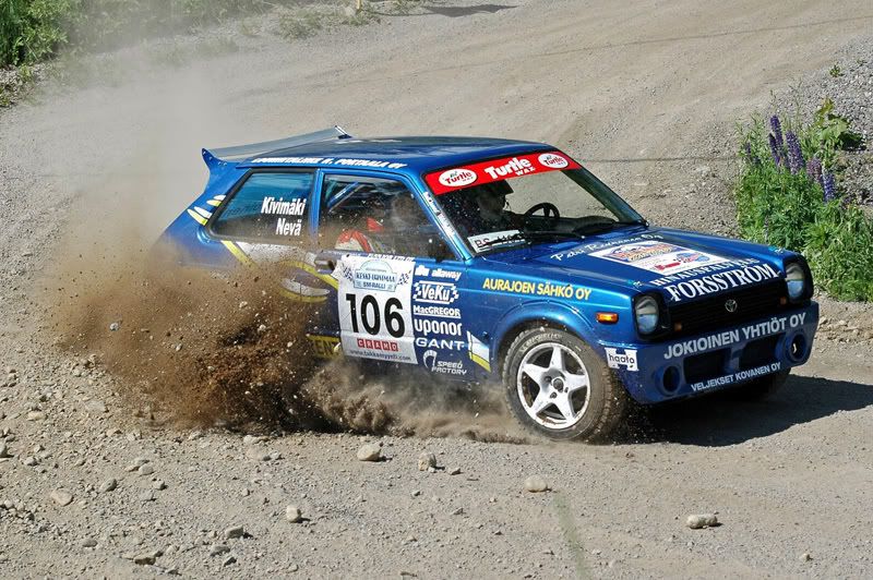

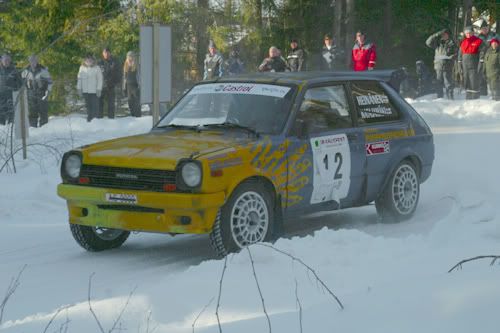

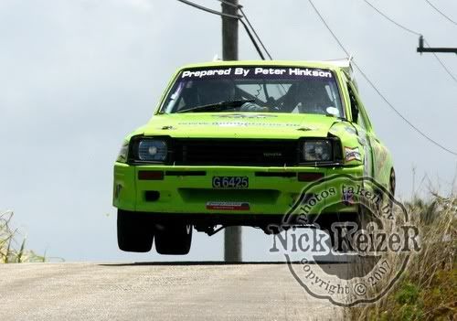

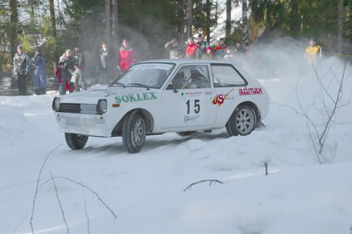

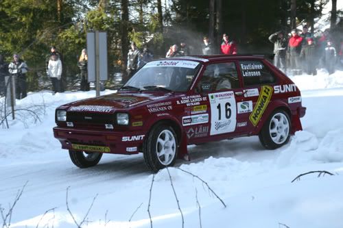

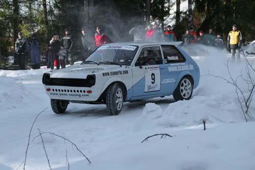

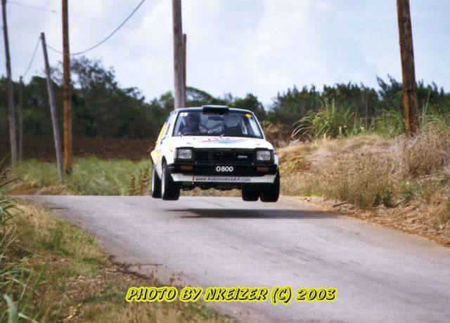

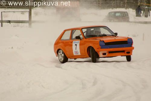

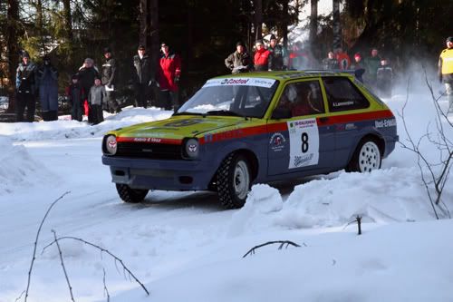

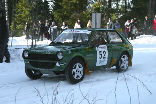

I'm really a huge fan of the bugeyes.
81-82's

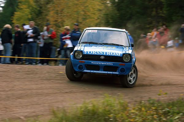

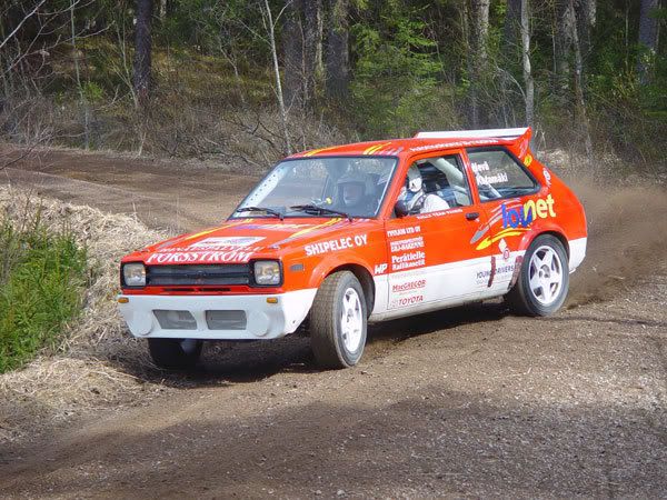

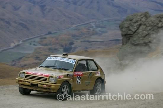

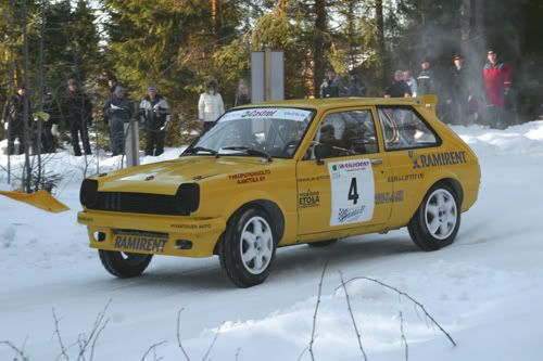

83-84's
