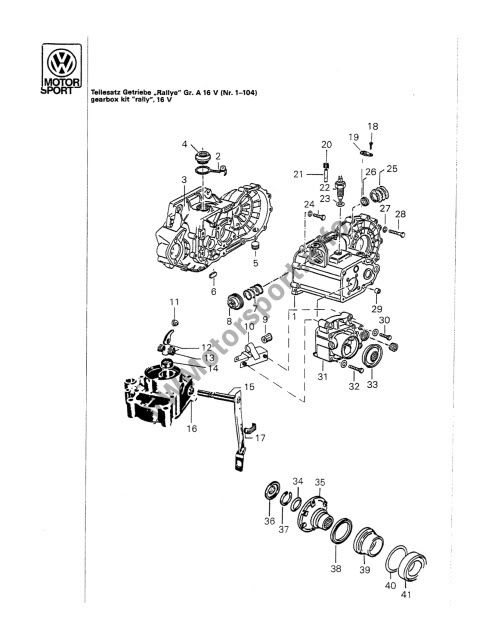

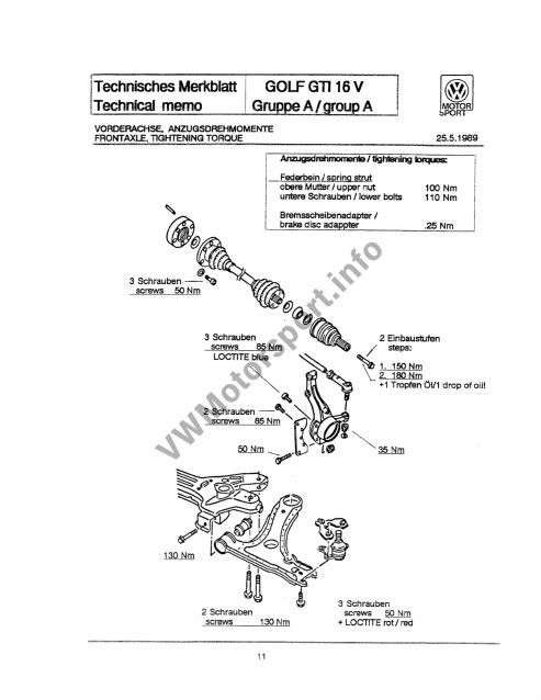

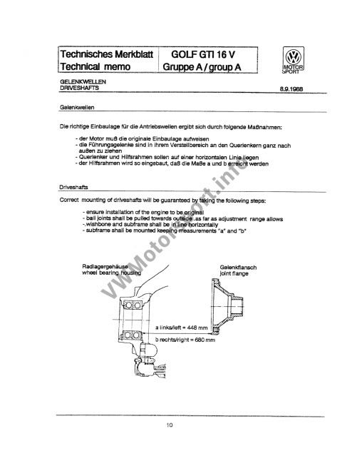

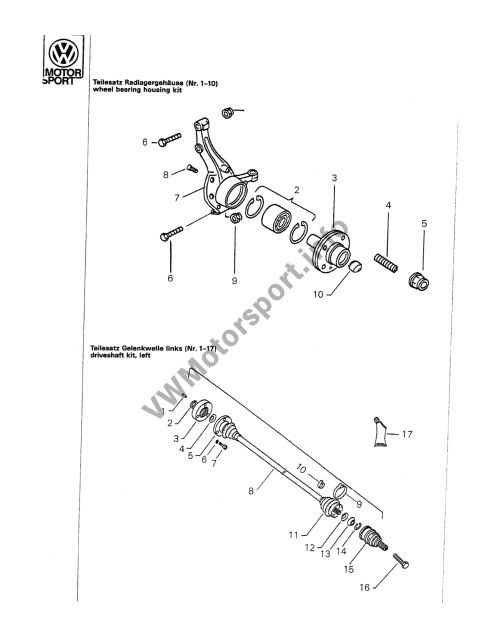

Not sure if this will help or not but this is some pages from a VWMS MKII Group-A prep manual I have
Most of this shiite is above my pay grade but it may help...or not.
Let me know if you want any other pages or an electronic copy you can zoom in on.
Good luck!
Jv
