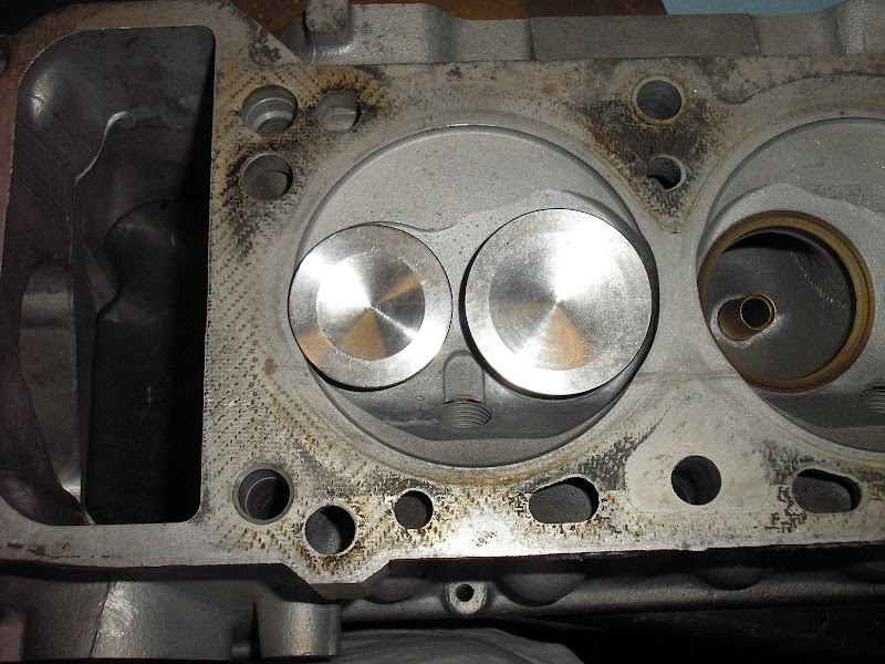

Brandon,
making power out with anything with the L series non crossflow heads is pretty grim task.
Ports and valve sizes aren't too good, and these days finding decent induction---manifolds, isn't too promising...
While i have a big soft spot for the CAR, I never was very overjoyed when friends in years past wanted me to build them L series motors..

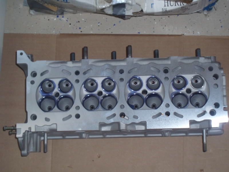

Didya know that the bore spacing and head bolt spacing is the same on the KA24DE?
In other words this:
With these ports
Will BOLT ON to the napz or L-series block, trather than this at best morphodite ex-Nazi schrot:
Even if you don't beautify the KA24DE ports till you jizz all over them they are lightyears ahead stock compared to insanely expensive, big valve L-series heads in terms of port area, and valve area.
What I'm suggesting is you would be ahead in the dollar spent/laugh return curves by BUYING a PART and figuring out the front cover and chain issues if any than spending TONS on labor trying to make a L20-B head make power.
And that's just flow.
The second and as important half of the equation is thermal and the nice pent-roof chamber with center sparkie plugskie is going to be TONS more detonation resistant than the old open chamber with crappy quench pads:
here's what some smart cookies are doing to give them some compression AND detonation resistance:
Looks like a lot of very expensive work to me, when there are much better alternatives just laying around in the bone-yards rotting.
Oh the intake valve size stock is 36.6mm for KA24DE, 42mm for the L20B so 2 x 36.6 valves is 52% more valve area than on 42mm, that means even a way milder cam will let the motor inhale way more fresh air than even rad high lift, long duration cam will allow into the L20B
