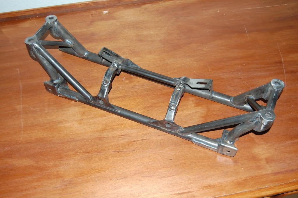

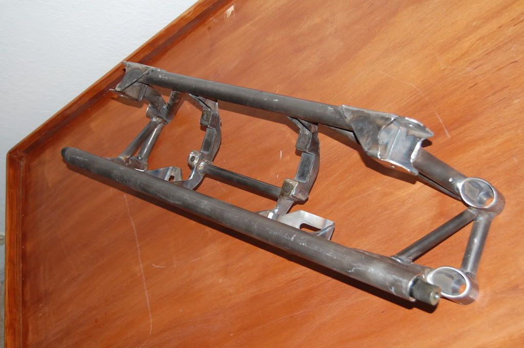

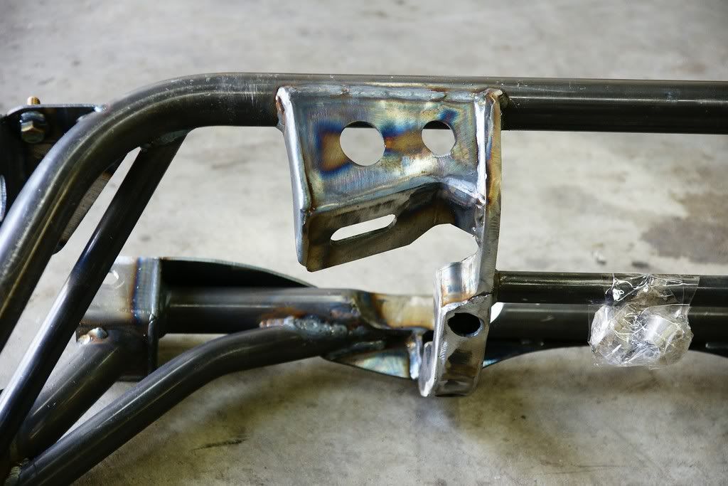

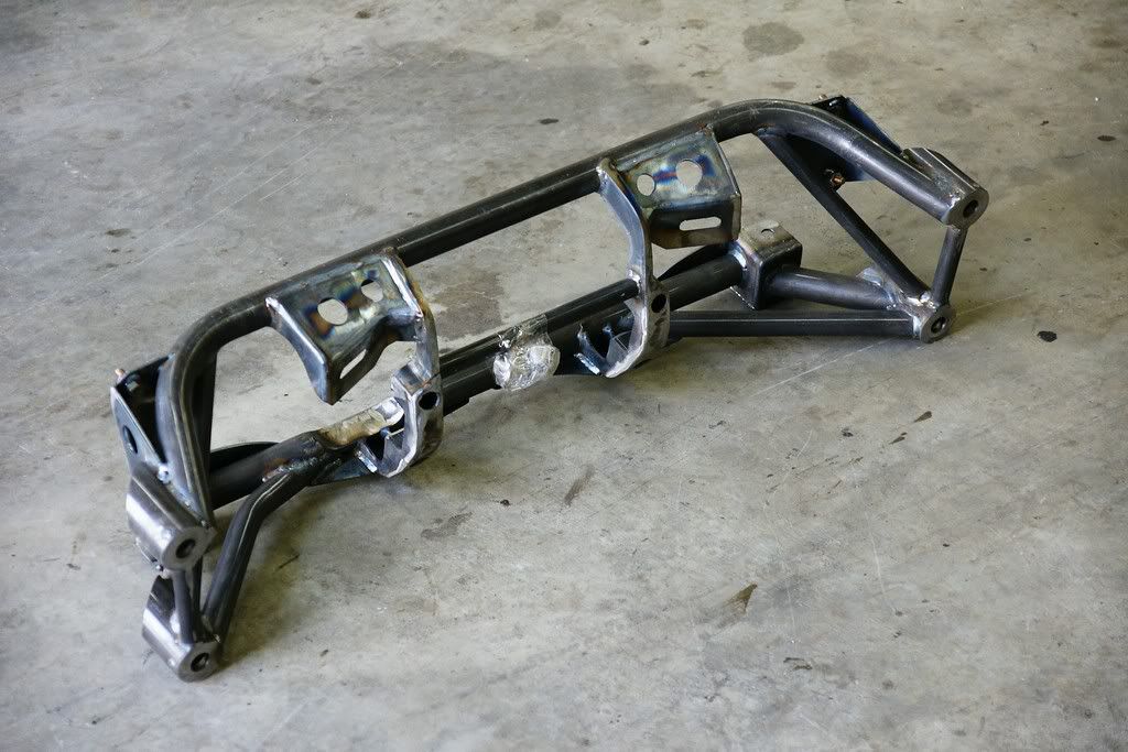

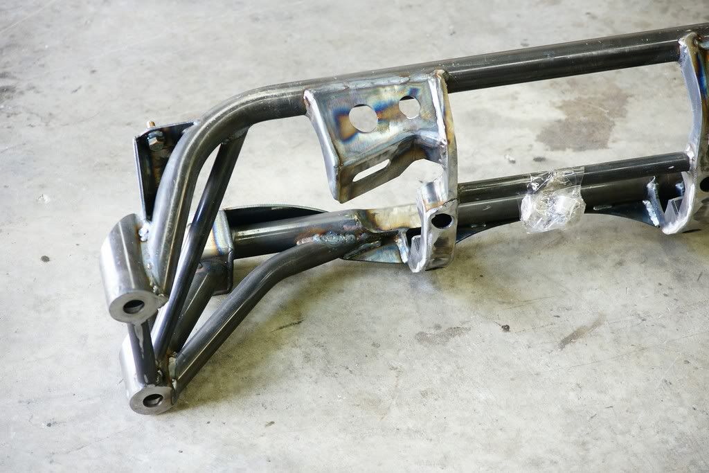

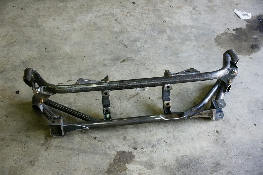

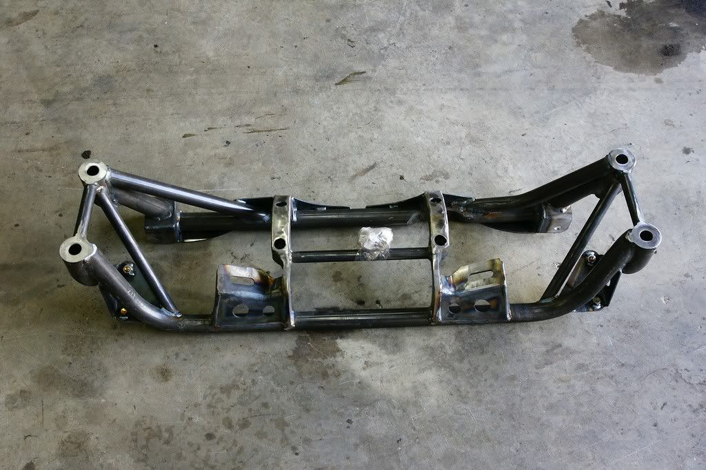

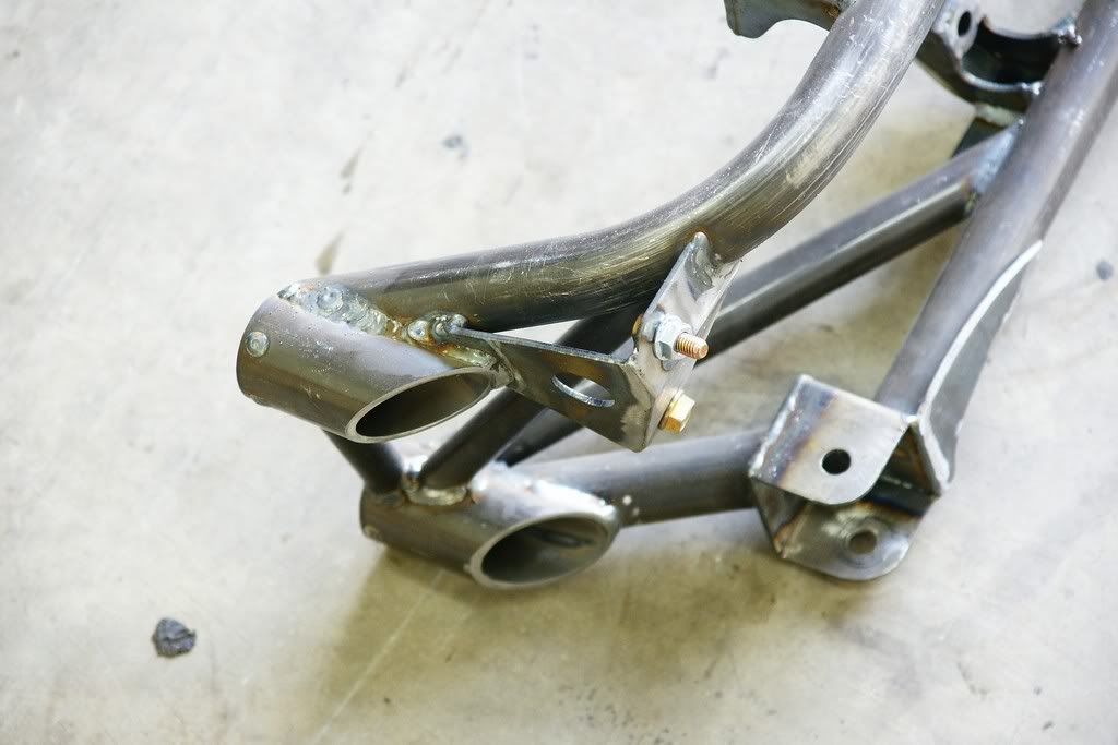

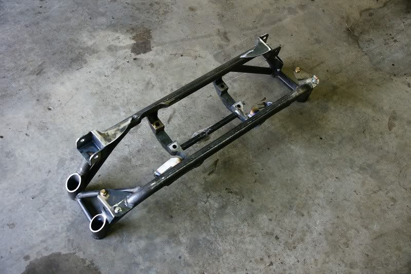

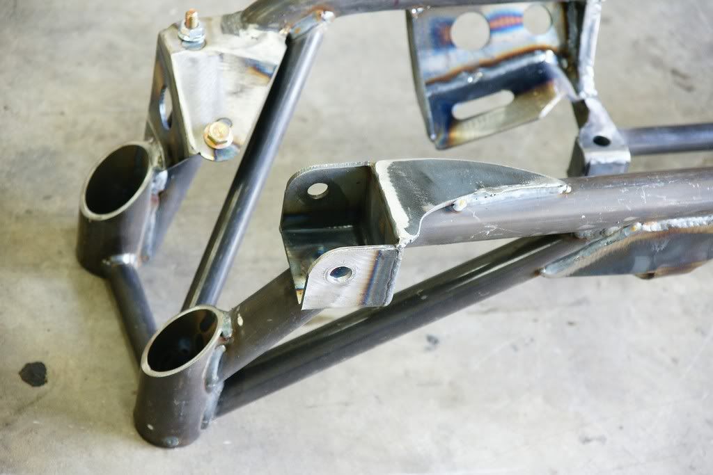

thought I posted these sorry I fail. I'm working on a frame now but I need a rack and pinion
from an sti to see if the hole pattern is different. The bottom of the frame as substantially more
bracing than the wrx frame.

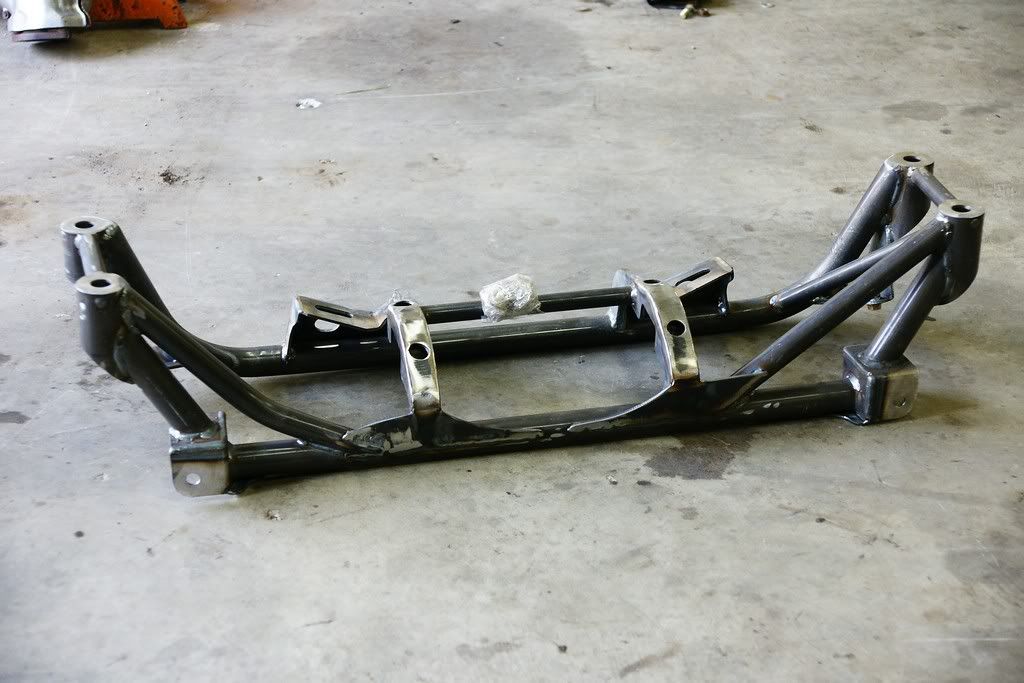

Re: Subaru front subframe project!! also need a stock frame
March 21, 2011 12:37PM

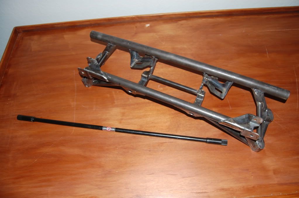

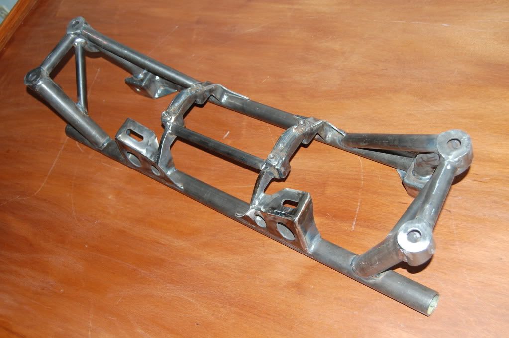

Um that was a lot of work. stock rack fits!!!!!
the sway bar is a 3/4 nascar bar and it should be about the same as stock might be a little stiffer.
If any one is interested let me know I'm getting really busy.
March 21, 2011 04:03PM
thanks ya the new bar is about 1" forward than the stock bar and
you can un bolt it in seconds and slide it right out.

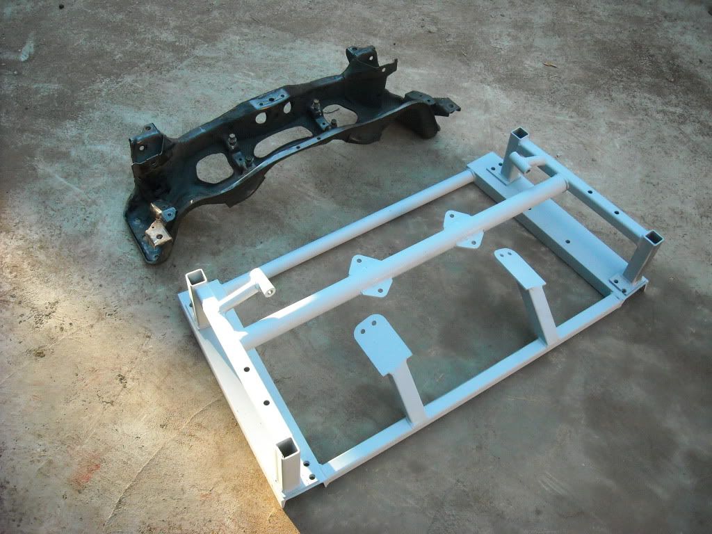

April 14, 2011 08:01PM

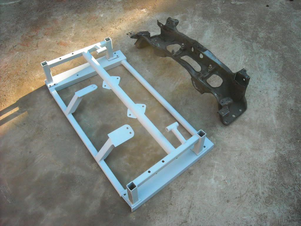

front frame for stock sway bar I think this will be a hit if I can do them
for a good enough price.

what's the weight difference?
April 19, 2011 12:19PM
not much like 10 lbs but the stock front frame is scary thin wile helping with a
6 speed install and we had a bar against the front frame pushing the trans up
and the whole front frame was deflecting.
April 19, 2011 02:21PM
Have you thought about the front jack point at all? I know this thing will be strong enough to jack but pretty much every aftermarket skidplate (if you can call them that sometimes) mounts to the front jack point.
