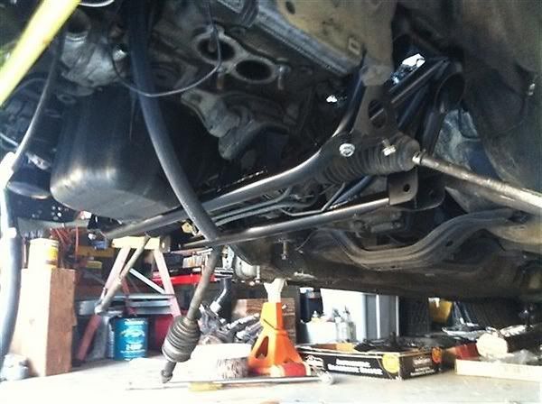

not much like 10 lbs but the stock front frame is scary thin wile helping with a
6 speed install and we had a bar against the front frame pushing the trans up
and the whole front frame was deflecting.
you have a cad file for that? done any fea on it?
no cad files just a build and test. not that I haven't pondered and made a
seres of educated guesses of forces and copied design ideas from wrc frames.
Leonbmx thanks for the support and the product you took off my hands!

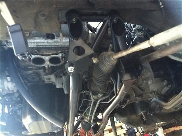

I have worked with the tube sway bar unit and just the install makes the swap worth it. If you ever have to swap a steering rack in service you will be glad you have the tubular unit.

Front sub-frame install in CA looks like it went well 2.5rs stock lines fit as well!
