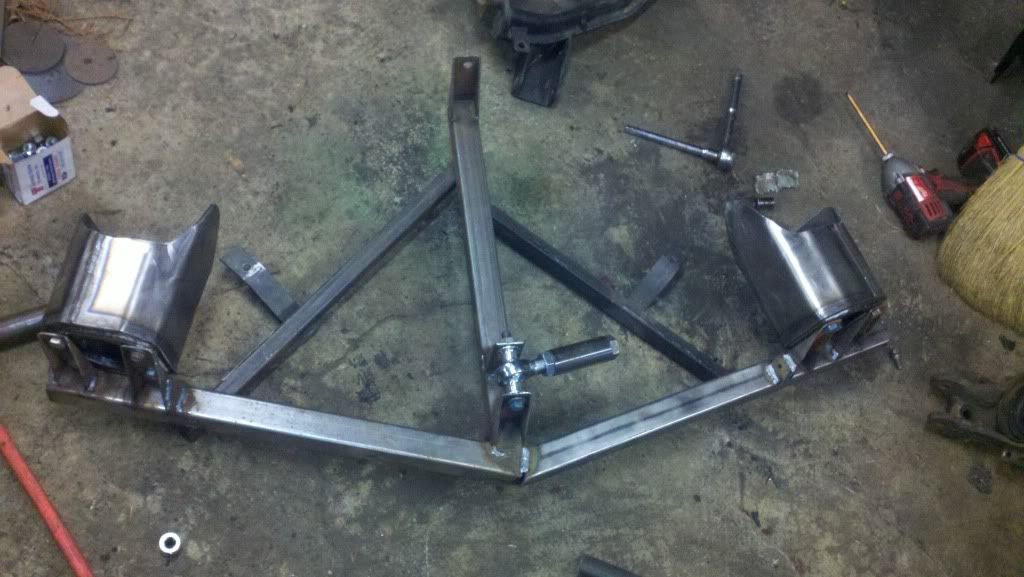

These are the front suspension goodies for Frumby's car. The old prototype version, and the new and improved way beefier version

for the non merkur perv in me, what am i looking at up there?
Re: XRATTY build
December 12, 2011 11:29AM
William is building custom rear Semi Trailing Arms, I am building front control arms and compression struts, utilizing a off the shelf replaceable ball joint. Fully adjustable for caster and camber
