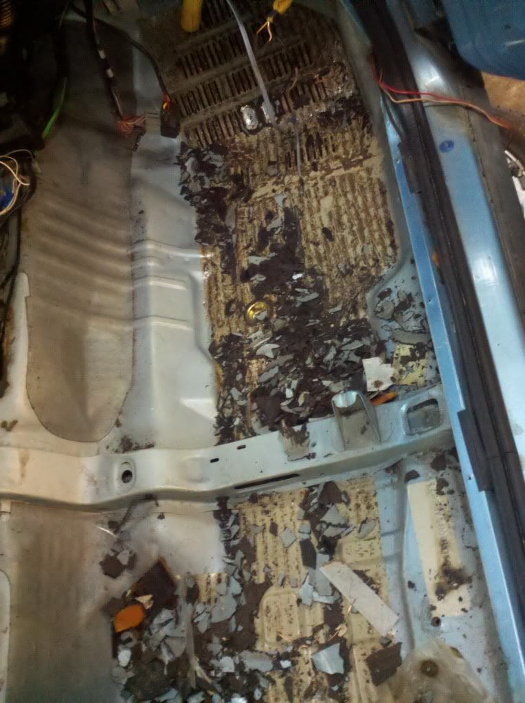

What the hell does a 64 Foul-coon have for undercoating?
If it has any its the old petroleum/tar shit and chemical softeners like our old favorite "Aircraft Remover" is the hot ticket.

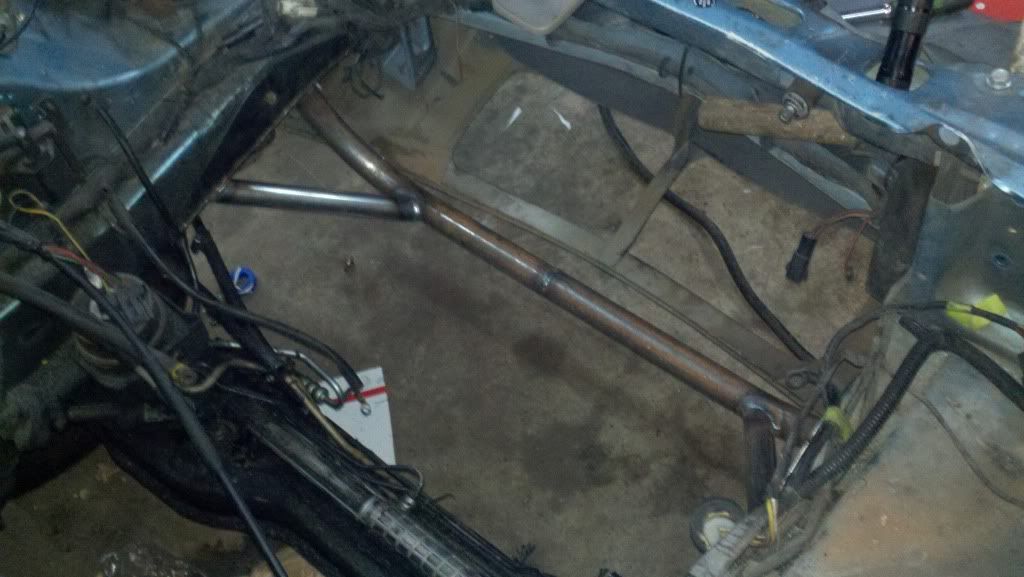

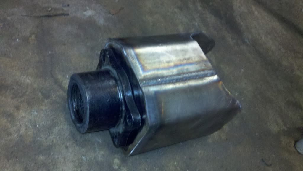

Re: XRATTY build
December 03, 2011 04:29PM
Re: XRATTY build
December 03, 2011 05:16PM

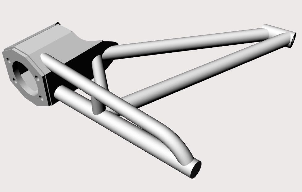

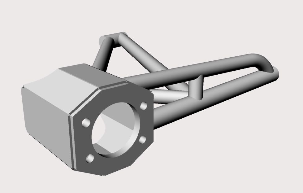

So excited to see the arms! What do you think the weight will be compared to stock?
I should have the front suspension arms done early next week, and we can bolt them on after we ream the ball joint hole in the knuckle.
Looking good William.

Yea... WOW. Sean.. still in for those control arms. Just let me know when/where/how much $$!
Re: XRATTY build
December 03, 2011 11:00PM
I know you are Jason. It's not like your car is in desperate need of them... BTW, I was there last week, and it is looking good!
Re: XRATTY build
December 09, 2011 05:26PM
Oooo, I like. Going to need something like that for the XRatty LeMons project soon. How much? Hell, how much for the bendy bits of the cage shipped out to Nude Hamster?

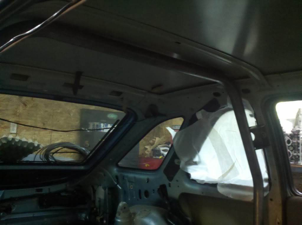

Dude. Did you see my message about LDR already having done an XR cage and that John probably still has the build specs in Bend Tech Pro and has a hydraulic JD2 bender. A few hour drive will be cheaper that cross country shipping!
Re: XRATTY build
December 09, 2011 08:05PM
I sent John Cassidy a message a couple weeks ago and only thing they've done is a main hoop, and I don't think it's in their software anyhow.
Brett and I can borrow a bender if need be, just we're going to be begging and borrowing unheated space for a winter installation and would rather just get right to the zappy-zap portion of our program. The 777 guys in California, dude, haven't gotten back to me either, but their price for 1020 DOM bent up bits is cheaper than we can get raw stock for around here...
Should've kept the rally shell for a LeMons car, at least I would've had some of a cage ready to go.
