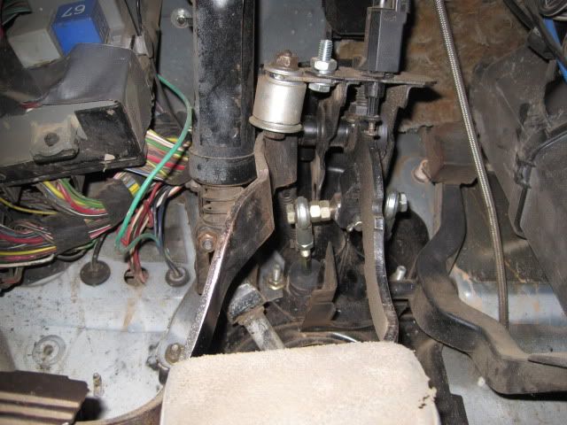

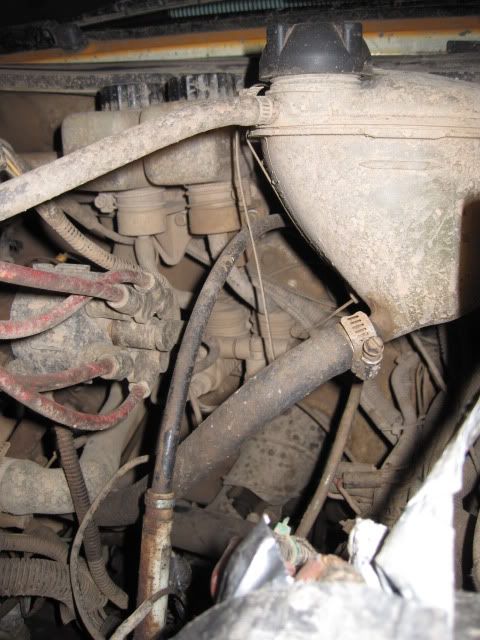

I've got dual masters on my VW. I believe it's the stock pedal box. Art Burmeister built the car, so I don't know all the details, but I can take some pics.
MCs mounted to the firewall, remote reservoirs mounted to the strut bar.
Inside, the stock pedals were modified to have both MCs come through and the mounting point was welded on to the brake pedal. I don't have a bias bar, so bias is adjusted by changing the bolts on the block (not at all ideal). As you can tell, I had to lengthen the arm on the front MC considerably to get it right, which required "modifying" the clutch.
Edited 2 time(s). Last edit at 11/17/2010 08:20AM by fliz.
