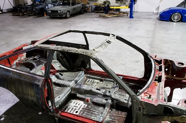

This is my OL car, a 88 all-trac. I've kind of neglected this car due to other paying jobs in the shop, but have recently gained the steam to bang this thing out. While I haven't been physically working on the car, I have been collecting parts for it. I recently reached out to JVAB to see if we can get something going for struts. I really want to drive this thing.

The message on SS you missed was that it appears you are way over prepping the car for starters. Extensive seam welding does no real good at todays speeds. I usually do a smidgeon around the cage mounts and the struts. Moderate prep, good cage, JVAB suspension and get on stage. The forces involved in smacking a 3000lb rally car easily overcome any shell prep. At that point the seam welding makes repair much harder, if it can even be fixed.

Back to the OP. Turbo All-tracs are fun but the shells are built like a tank. I wouldn't even bother to seam weld one because they're so strong from the factory. Getting a good good struts on it is priority #1, next is getting a good plate style rear diff, and then change out the brakes for st-185 parts (yes, it's downgrading to single piston front calipers but they work better and you can get good pad materials). That's where you stop...resist the urge to do anything else cute and time consuming.

Hilariously one of the guys telling you "I never seam welded anything!!!!" said Subarus are built tough"
Oi!
ALL modern cars are very lightly built, Subies no worse, but certainly no better than any other piece of shit, made out of the foil in my ciggie pack, origami junk.
Thus, if somebody says "Subies are built tough" EITHER they're very slow and/or haven't a clue what tough is.
