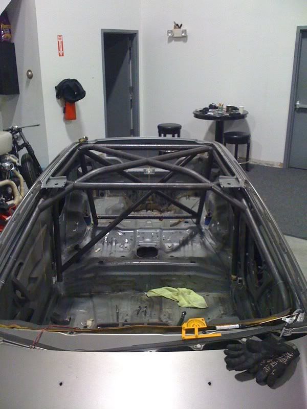

I've been working on the celicas a bit and have decided to cage them both at the same time, got the metal & everything. John told me to talk it out w/ the board before I started cutting & bending. So I got my art's & crafts on. This is the cage's I plan on putting in the cars, give me some input guys. No solid works for me.
A couple of questions:
- Can I put a "slight" bend in the british bar to get it closer to attach to the door bar?
- Is there advantage in running a bar from the bottom of the main hoop to the rear shock towers More strength???
- What thickness of metal are you guys using to plate the shock towers?
- Attaching the A pillar bars to the front shock towers? Worth it?
I know I'm forgetting something.
We practiced a bit on a customers car, w/ some of the things were going to do on the Toyota. There was alot of owner input in this cage which is annoying. low clearance door bars, retain door guts, factory dash bar etc...... whatever keep the lights on. :-(

I believe the overhead bars to be within 100mm of the header bar connection. There is nothing to be ained by having the header bar ends bend backwards like you're doing. It would be better if just straight across the top of the windshield, or nearly straight.
A-pillar support can be bent outwards 20* to improve fitment and increase knuckle room on steering wheel. Don't overdo the main hoop/lateral 45* reinforcements, the ones beside the helmet. 253 has some max dimensions on those.
Door bars need not be too high and hinder egress also.

We do the top spreader bar like that for window clearance, it also makes it easier as you only have to make one bend on the roof x, for more head room. The celica doesn't have much. I like to think the supports connecting the a-pillars to the spreader bar would give it a bit more meat in a multiple roll...rollover compared to the bar just going straight across.
Also what's everyones take on harness mounting? The Celica's hatch is pretty useless. I was planning on running them to the bar connecting the rear strut towers.
Re: Hello from Arlington Celica Party
January 28, 2011 10:44PM
Yes, run the tubes to the front struts, the front of the car takes a beating. I just fixed up Adam Crane's Corolla that basically was close to collapsing the front end.
I initially had a harness bar between the shock towers on mine, although legal, Gene gave me a bunch of grief, and I added bars behind the seats.
For the rear shocks, you may want to put in a tower, those mounts look pretty low. Whats the longest shock you can get in there?
