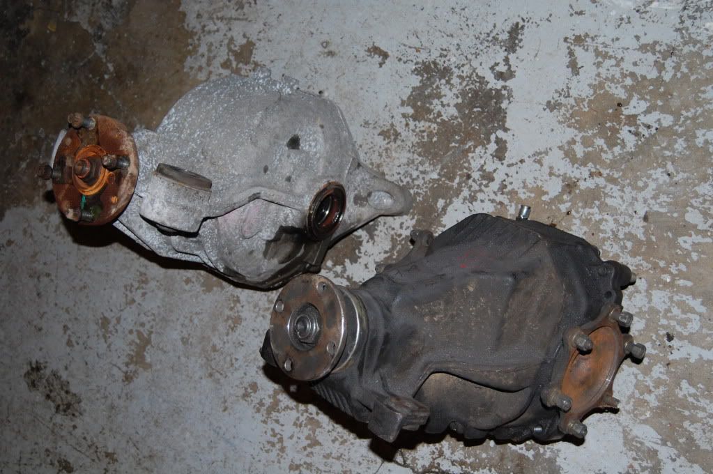

hear is a look at the explorer diff with the supra diff
both of these are open diffs and the supra weighs 79lbs
and the explorer is 69lbs not a big deal to me just interesting.
With out the ears in the back of the explorer diff it would barley
have a larger foot print than the supra or most anything that
is as big and nasty as these two.
