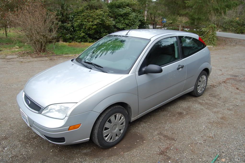

OK the first ingredient the car!
This car is loaded with options like ........ never mind
What I got for $3000
2005
110000 miles
5 speed
2.0 duratec
I wish I was a better story teller because the whole idea of a focus race car really clicks when you
first experience these funky hatchbacks. First for 3000 I didn't car to drive it i just said thanks ill
take it. and a friend drove it home for me. So when i make it in to my own car I know what makes
the car cool but the first drive it sealed it for me. It fit me ok but the whole feel of no switches now
nav system no bullshit made my mind scream for a roll cage and a dirt road. The drive was good little
soft in the corners but ok dampening but what I love it the car is small with a long wheel base 102.9,
you can really throw the car in to corners and never worry what the back end is doing.
All I have to say is this is the car for me rwd this would be the perfect beginner to professional
race car with a real world price tag
So this is the plan for this little bugger is to do a quick rwd set up, I am just going to use all of a
supra rear end and a miata tranny
so the gears will be
6MT 3.760 2.269 1.645 1.257 1.000 0.843 rear end will be 4.56
so I just entered the the last 5 gears because I can start in second. If I was going to go race
this car I would go one more step to 4.88 and if I had a hot motor that could do 8500 + I
would use 5.13
