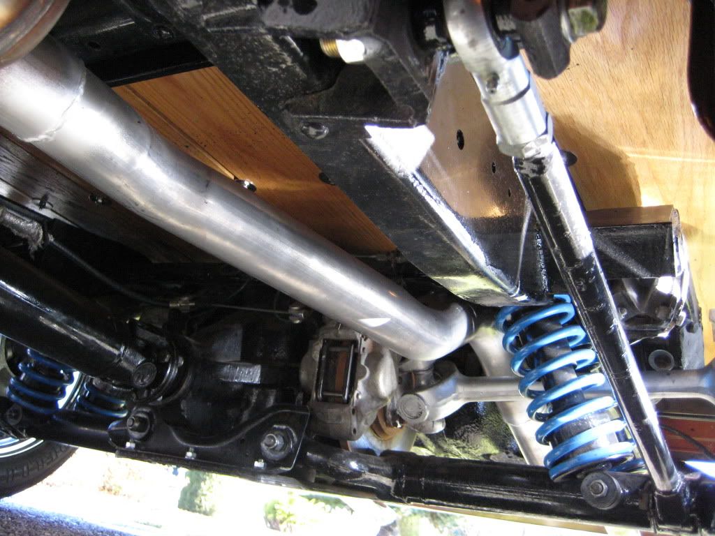

Pretty much everything is a subassembly that bolts up with four or six bolts, that way the assembly line part of the job is quick and simple, and you can more easily isolate the suspension from the driver with another layer of rubber (or fancy hydraulic) bushings.
I remember a co-worker threw a Thunderbird IRS under his 50's Chevy pickup about ten years ago. Real easy, just do some measuring, make some places for it to bolt to, and he sent the hubs out to be redrilled to Chevy instead of 5x108 (who the hell uses that?). I think his driveshaft even worked properly. Bear in mind that it's a simple frame design, and all it had to do was be better than the 2" travel leaf spring solid axle he was pulling out.
