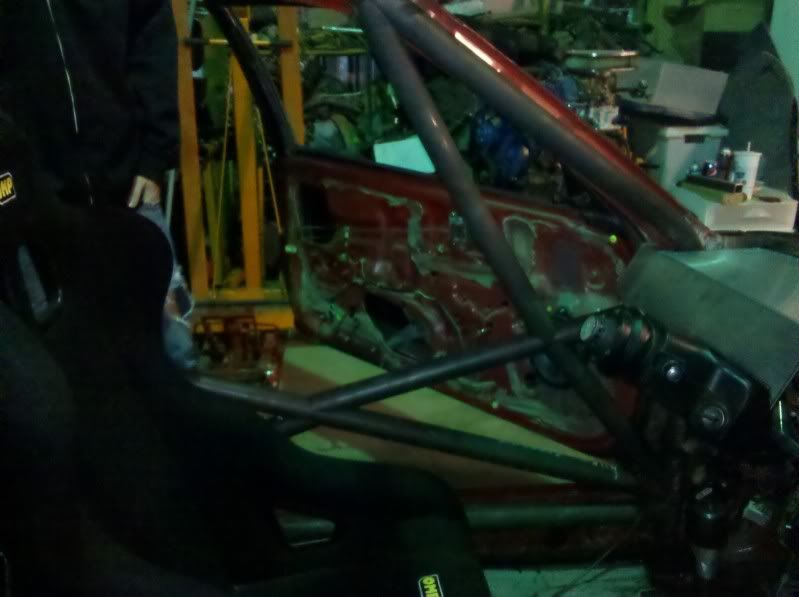

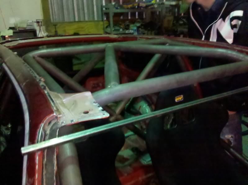

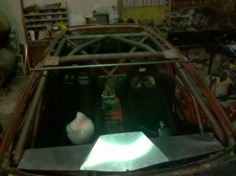

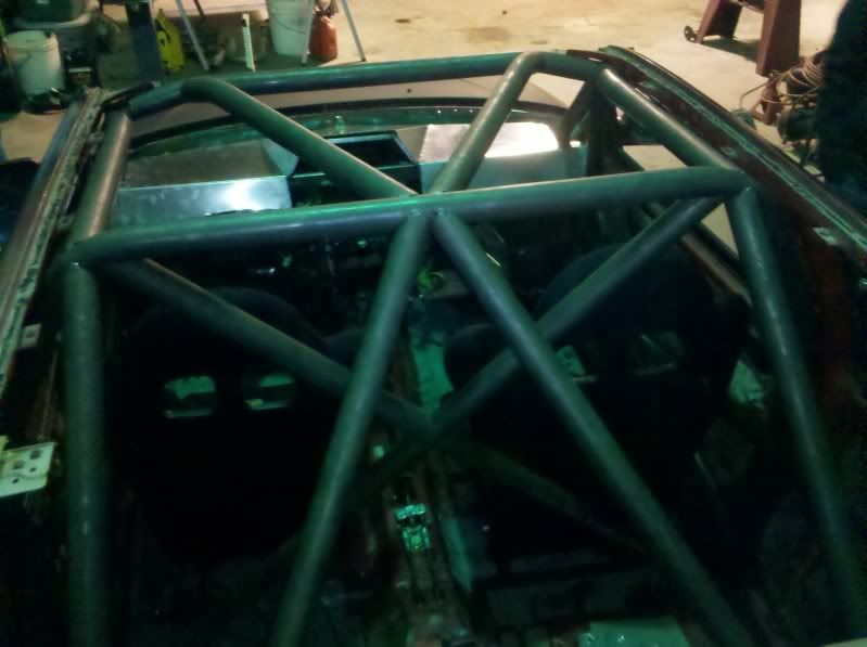

Hi guys I just wanted to post up some pics of my cage in progress. It's just tacked in there now and I wanted to make sure everything looks legal before it gets fully welded. That being said I know we still need to do gussets. The roof came off because it had a sun roof. Anyway on to the pics.

The roof reinforcements (V bars)need to be within 2 inches (100mm) of the junction. Looks like it might be a bit more than that.

After checking the FIA site it is definitely 100 mm. I'm having them measure the gap but it might be more then 100mm anyway. It's not a huge deal now since we have extra metal and the roof and windshield are still off.
Re: My Honduh
February 26, 2011 08:53PM
100mm or 4 inches..sorry about the confusion. Its an old people thing....if it is within a small overage that is ok. If you can put a couple of windshield bar braces from the roof bar area to the A pilaar bars then it would be even better.

They will be adding those braces as well as a diagonal from the main hoop up.

Hey, add a tube from the base of main hoop up to the backstays where they hit the upper shock mounts. Not required by the rules but required by logic.

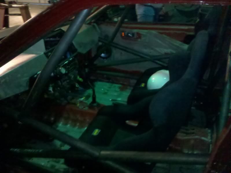

-One small suggestion: possibly move the driver-side A-pillar support bar 3" down from the top junction so you will have a little more room to get in and out. If you ever install a drvr seat with "helmet wings" you will have issues with egress-ingress.
