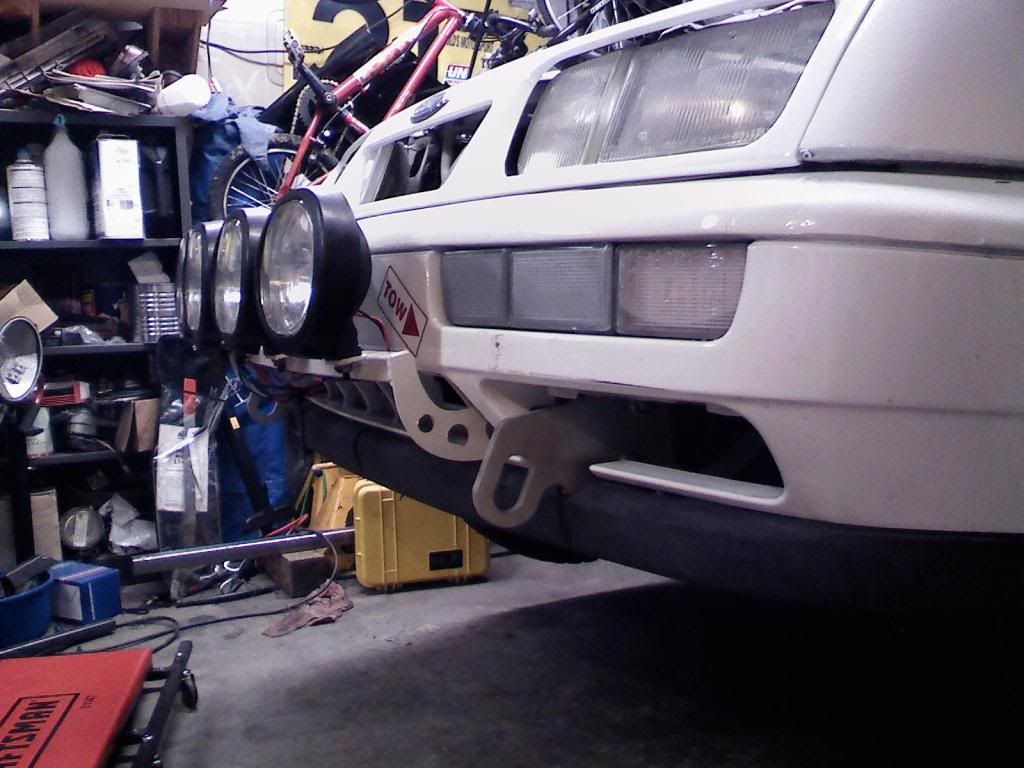

Here is mine. William cut me the curved parts, they have slotted holes at the end that slide under 2 bolts on each side. The bar is 1" square tube I contoured to the bumper. The lights are cheap harbor freight lights with good quality Sylvania silver star bulbs (which cost more than the lights) I am happy with them. pointed to outside ones across to the other side for corner illumination.
Looks nice, but your "TOW" arrow points at the light bracket....I'd paint the real tow hooks orange or something just in case. You also need a front license plate if Washinton tagged and probably most other states. Not a tech issue btw.
I hadn't actually looked at a schedule. If they have 60 cars people will be running in the dark for sure and it may be raining, so forgetting my joke at JVLs age this should be an important project.
When I first started we used 2 KC Daylighters and 2 flood style from the local log truck supplier. The KCs lost a lot of bulbs. Vibration or too hot or just a long time ago and material issues...
Mount them higher than lower if possible. You can even partially stack them. Crowd 2 lower lites a little bit and then mount 2 pencils slightly above.

Tow hooks are orange now, and it has a license plate. That pic is quite old.

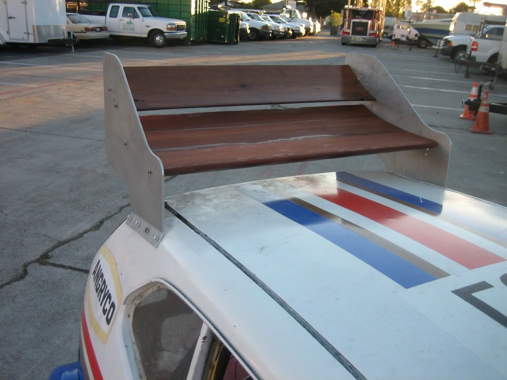

Don't be making fun of cellulose composite aero enhancements...it's all in the execution not the material smiling smiley
Team "Old Growth Redwood" on the LeMons car:
