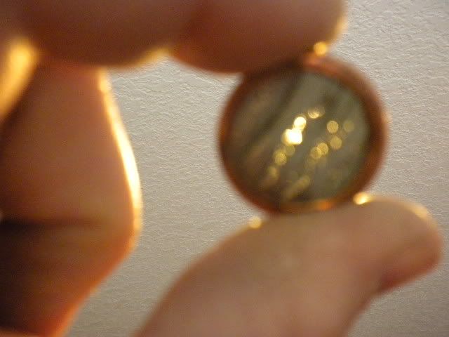

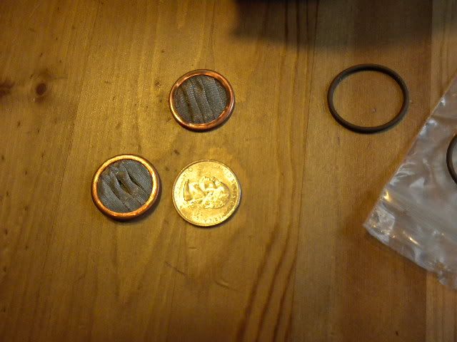

Here's what we have it's almost exactly the same as what John Burke "just replaced his oem filter with"
and for future referance here's what it looks like clogged:
not clogged:
and a size comparison:
we just cleaned out the tank and the have a sock on the fuel pump, I think the filter works extremely well and doesn't have enough capacity

Re: Fuel Filter
May 07, 2011 01:54PM
sidewaez
not clogged:
John V is this the saab filter you're talking about?

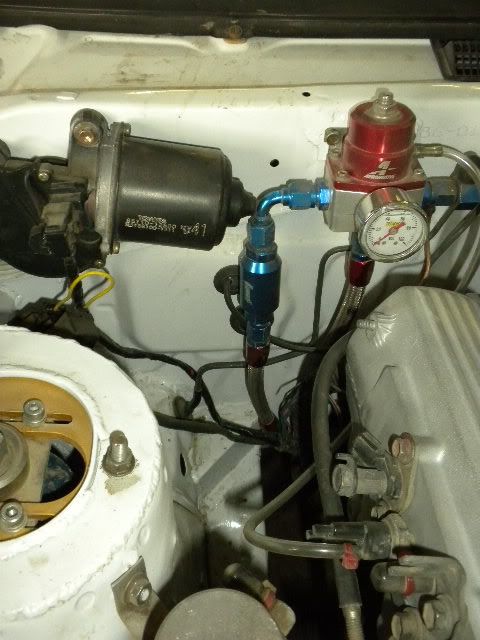

Blake I think you're right. (And Jon should think hard what a plugged filter is going to to to his Subarat motor which we know are not particularly durable ----a little starvation and it goes a smidgen lean and KABOOOOOOM!)
Just look at the area/volume.
The big Bosch ALL METAL thang generally go a million miles and particularly the VW versions have a nice simple bracket..
Gotta ask: whatcher got that fancy schmantzy pressure regulator and gauge thang for?
You have some insane pump you need to regulate down for the Toyota? Adjustable? Maybe you could scoot it over to make room for the Bosch filter
Re: Fuel Filter
May 07, 2011 01:56PM
I agree that filter lacks capacity. As soon as one of those little screens gets plugged you're poked. A standard old Chevy truck from about 1988 thru now will have a nice filter, available most everywhere. Uses a modified flare nut arrangement on both ends or the Ford filter Sean mentioned. I would avoid any filter that uses a banjo fitting and sealing rings because they are more prone to leaks and its easy to lose the seal ring in the heat of battle.
There should be plenty of room to mount a filter there, just add some line for a loop or put the filter in the back at the tank and leave the screens out of the little one.

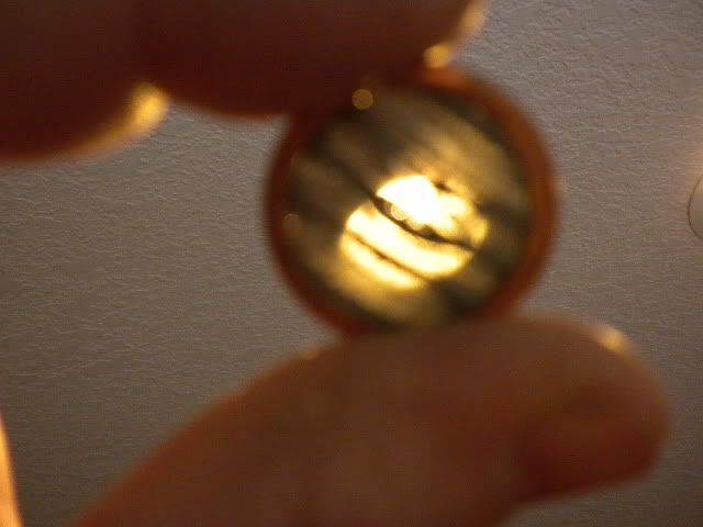

hmmm...the filter I linked to looks very different on the inside (in a good way, I hope)....I'll snap a pic in a minute here....
