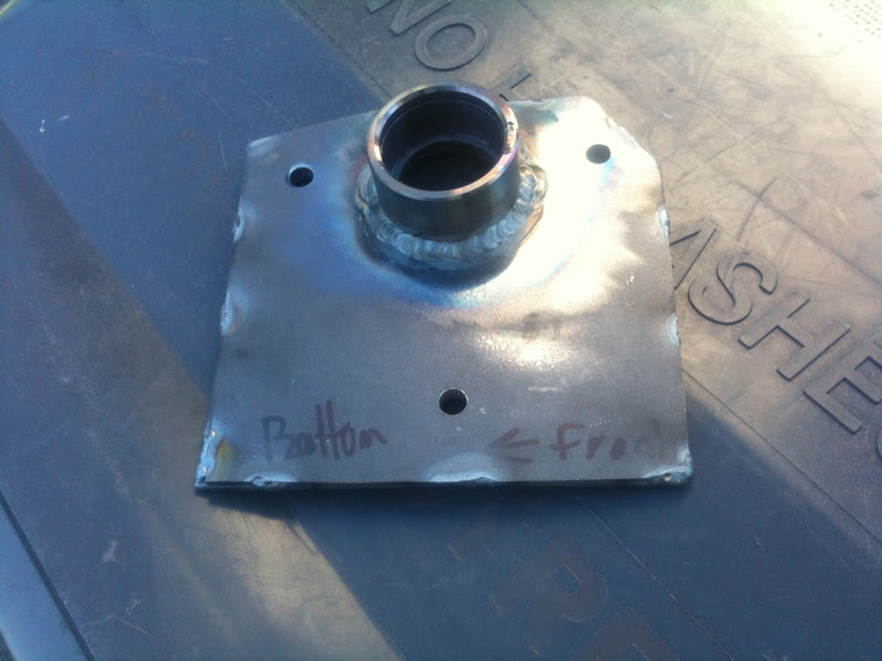

Ok so the parts finally came in, after racereadyproducts.com fucked up my order and having to waste another weekend...
KISS is the motto for these things, mostly because I have a sawzall and a less than stellar drill press.
Plate material is leftover from the cage mounting feet, whatever thickness that is. I doubled up on it so hopefully the plates wont bend. And the bearing cup is welded to the bottom, so it wont come up and through anytime soon.
Bottom:
Top:
And attached to the strut with the mounting studs from the stock top hats pressed in:
Installed view, passenger side.

So with the strut top pushed in like it is now, and my 10mm lengthened lateral links, I now have... 1.1 degrees of negative camber! ( + or - 7 degrees, I measured using my iPhone)
I put about 25 miles of gravel back roads on them this afternoon, seemed to work ok, they are clunky because the bearing cups are 0.018 taller than the bearings. I hope I can find another spacer to fill that gap.
I would be a little concerned about the poor fit of the uniball in the cup. I usually have to re-machine the cups after they have shrunk from being welded and even then they are a press fit and they have to bottom out completely to get the snapring to seat. If they are loose enough to clack up and down you are running the risk of hammering the snap ring out of the cup and everything else with it.
