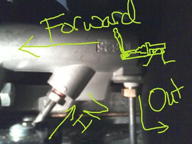

Ben if push rod is goung this way-------> the the cup of the seal MUST be this way<
OK?
Check you master cylinder.
Rememebr the old rule of thumb:
If it worked, then you "fixed" it and then it doesn't work the problem is between your ears.
Also, please post a photo of your handbrake indicating in and out.
I don't know how often guys plumb 'em backwards, but at least 64% of the time. Or less often right than sheer guessing (which would be 50% chance of getting right since there's only 2 choices).
Any time I see 64% error then I know it's the result of 'reasoning".
So check master ,post photo.
We'll get this sorted, don't worry.

Re: Caliper seized...maybe
June 08, 2011 11:52PM
Here's the handbrake plumb in/out:
And tomorrow I'll do a bench bleed on the master then re-install it and see what happens. (Yeah, I took it out, hoping to see if I could see the alleged seal that may or may not be the right direction. Didn't see it, it's buried inside.)
