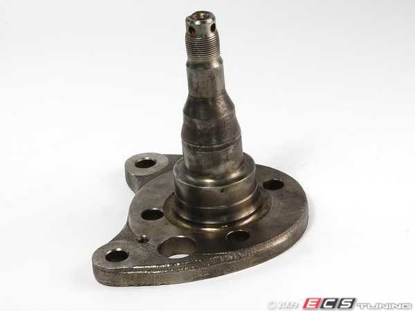

I think a good solution might be to be able to bolt the mk4 VW (2000-2006 or so) rear stub axles and bearing assemblies on the older cars.
Like taking this mk4 part
http://i104.photobucket.com/albums/m167/TASV6/Corrado%2024V%20V6/DSC00555.jpg
and cutting off the end-plate like so (or just having them cut from steel--TSS)
http://i104.photobucket.com/albums/m167/TASV6/DSC00556.jpg
And then either drilling new holes to bolt the mk2/mk3 rear beams or weld them directly on. Then you can bolt on the mk4 stub axles and bearings that look like this:

But to your issue. Welding a plate with matching threads for the MKIV stubs seems your best bet. That way, if you bend a stub you don't have to replace the whole beam. If you hit the stub hard enough to bend it, unless you did the VWmotorsports trick of bracing, you probably bent the beam anyway?

Fuel cell is only if you do the VWmotorsports supprots on the beam since the fuel tank is located the same place you put your supports.

That, and although I've gone through quite a few rear beams (MK2 & MK3), I've never bent a stub axle or had a bearing failure. I have to tighten the bearings almost every service, and I replace them when I do rotors, but no failures.
And even rear beams...it just bends further and further, it doesn't break. And it really only bends if you're pounding the rear end off the banks. The worst I had was WV where the car was driving sideways down the straights by the end...and even then the handling wasn't TOO bad.
Just the weakness of the rear beam would make me want a bolt-on adapter plate to even consider this. Then it all comes down to a cost savings on rotors/bearings vs. cost of the initial setup.
