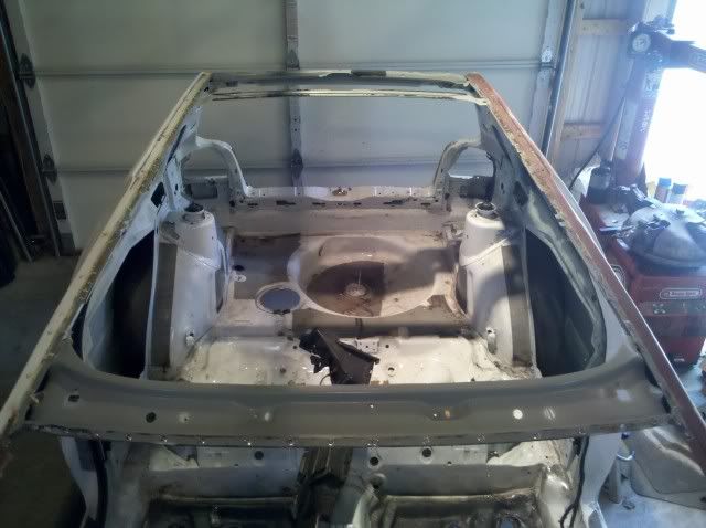

I didn't do it myself, but I believe it was fairly easy, just a bunch of spot welds and some seam sealer.
New non-sunroof roofs are $50 from VW, so it made sense to just cut off the sunroof roof and replace rather than fill the hole.

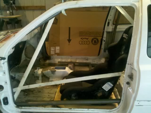

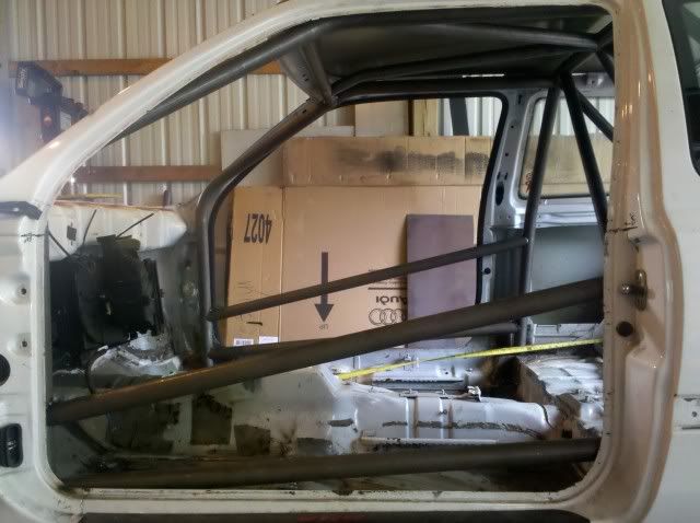

Cage builder is having second thoughts on the door bar design.
Here's the two options, laid out in intermediate strength masking tape.
The sill bar is staying. So single cross bar, or an X?
The X will make connections to the A-pillar support much easier to do and gusset. But it does make it a bit harder to get in and out of the car.

Ask your self why the door bar is there, and go with the stronger design that is a slight bit harder for ingress/egress. Rember, they are there to keep stuff from making it into the car when you hit something. Take it from a guy who has hit a tree hard, make the door bars as strong as you can.

I went with the old school sill bar and angled door bar. I really like how easy it is to get in and out of the car.

We went with two bars in 1.75". I'm comfortable it will be plenty strong.

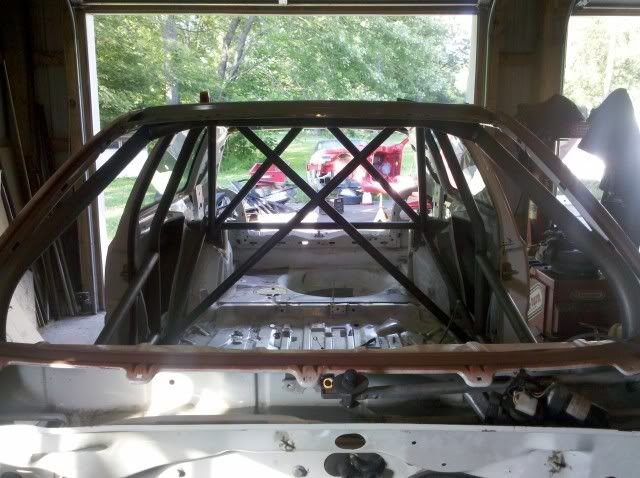

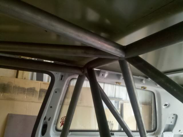

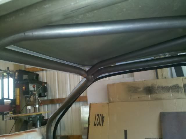

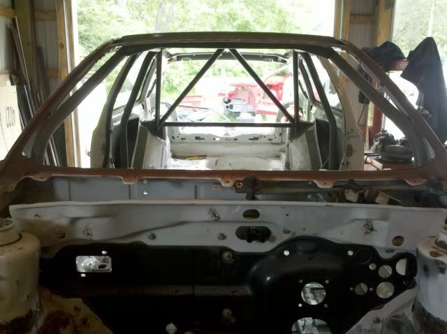

Some xXx action
Roof bars

+5 on what Robert said.
Sill bar, Single angled bar, and the a-pillar bar. Also means you don't have to add more gussets where the a-pillar support intersects the door bar since they don't anymore.
