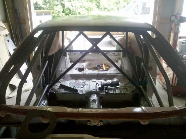

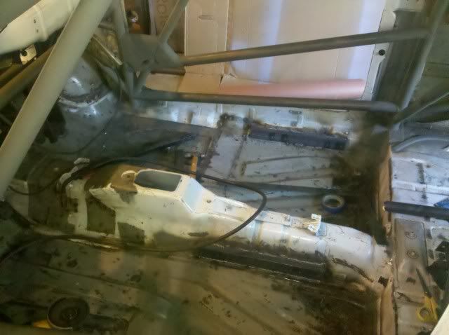

A few more pics...almost done with the cage.

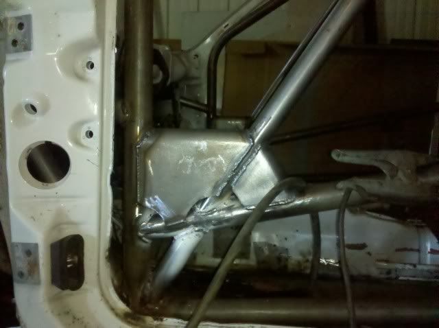

Windshield tie-ins:

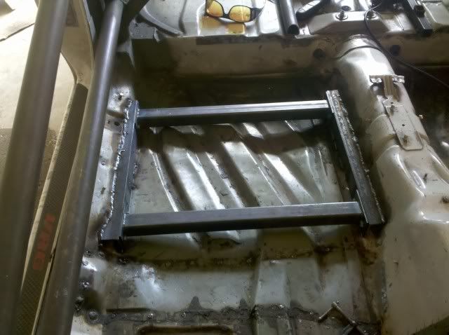

FIA seat mounts, made with extra holes for additional adjustability.
