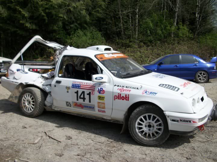

And we walked away from this. He is building my next cage too. I show this because building and welding a cage together really is a serious thing. Your life does depend on it. If you are just a hobby welder like me, then consider paying a professional to build it for you. It may be cheaper than you think, and save you in the long run.

September 21, 2011 02:16PM
an xr4ti would make a neat looking truck.

September 21, 2011 02:18PM
I was thinking that as well. Looks like an aussie ute.. What do you charge for that conversion? smiling smiley

Re: Cage builders.. favorite tools?
September 21, 2011 02:38PM
Some guy has put a Subaru BRAT tail end on an XR4Ti.
I def don't take this part lightly. Took a good bit of welding in a Tech Highschool a long while ago, been hacking on Jeeps with my mig since around 2004. Lots of work on our comp rock crawler that saw a ton of abuse (though not the same as whacking a tree at speed). I'm pretty confident in my ability, especially after going over ever cage I could at the last few rallies I've been to.
I will be ordering up some 1.75 0.095 and cut/notch/weld/cut for a few months just to get used to that stuff, I'm used to working with much thicker tube. If I don't like my results I'll be sending the car off somewhere no doubt.

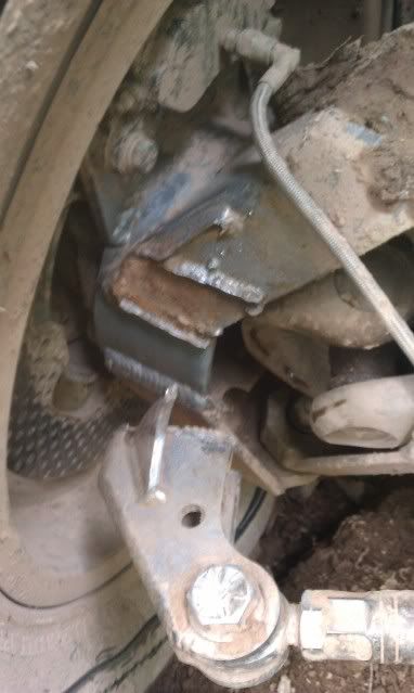

Also finding a 'pro' can be a bit of a crapshoot. A supposed pro on the east coast put this together :
No welding issues there right?
I do have a quote from a guy I'd trust to get the cage right, but its a bit of a logistics issue to get the car there.
