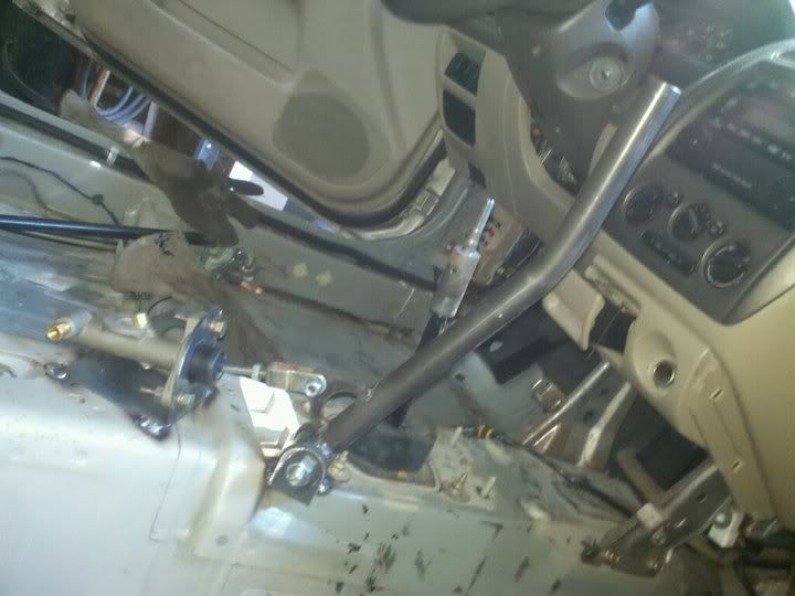

Re: hand brake options?
October 13, 2011 09:51PM
i had one from checkpoint racing (i think) in the mazda. it was the shop in colorado. is that checkpoint? anyway, here is the best pic i could find that is already on the internetz. the stick needs a shift knob, which it doesnt have in this pic.
