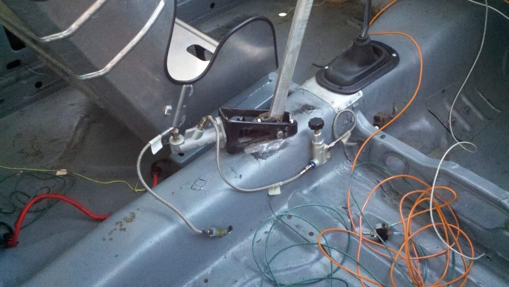

Tonight I started the bleeding process (brakes not blood thankfully) I had my daughter doing pedal duty while i ran around and performed the obligatory bleeding at each corner starting with the farthest from the M/C. I decided to pull the hand brake all the way back during this process. I asked my daughter every time i opened the bleed screw if she felt the pedal fall she told me know (only on the rear brakes) the front she could feel it. I then noticed that the hand brake was in the forward position. Hmmmmm i thought ok lets try it now with the hand brake in that position. She could feel it this time and all the brakes were void of any air. I had my daughter pump the hand brake a few times and I instantly noticed the reservoir spilling over the top. So after all that what have i done wrong here is a pic to help with my setup.
The line coming from the front of the car is going to the M/C and the line from the back is going to the rear brakes. I also noticed that if i pulled the hand brake back and pushed on the brake pedal the hand brake would try to go forward. In its current state If I pump the hand brake it is easy to pull then if i pump the foot pedal it is easy for about 2 pumps then gets stiff again. I looked on the hand brake cyl. for a flow chart but I did not see any. Could i have the cyl. plumbed wrong? Thanks for any help you can give me.

well everybody says I'm all opinionated and know-it-all and a generally sociopathic dooood and everything so I'm loathe to criticize so I'll turn over agnu leaf and I won't.
Nice install.
I will meekly point out however that I almost always try and plumb the hard line from the footbrake master INTO the INLET of the handbrake master, and it usually seems to work better most of the time.
And bleeding goes a lot better-er.
But hey, who the fuck am I to say anything? There's really no right and wrong and like everybody has their own like reality, man, so you want to do it that way, then cool, doood. Maybe they switched the inlet to where the outlet has always been, maybe that one master was like unique, maybe cosmic raaaaaays like fried a synapse in the brain of the dood machining it!
Maybe this drawing is like all fucked up:
More guys do it that way first than the silly drawing.
They should pay attention to customers, I mean so many do it the way you did, they ought change it.
Edited 1 time(s). Last edit at 11/08/2011 09:36PM by john vanlandingham.
Re: Hydraulic hand brake bleeding
November 08, 2011 09:38PM
You have the lines backwards on the master. On those Girling type masters the feed port in the front one. Just switch them around and you'll be good.
November 08, 2011 10:00PM
They already do homie. All the good modern (less than 40yo) master cylinders dont have the fluid flowing in reverse like those. Look at the Tiltons, AP, Alcon, Brembo. If the piston builds pressure towards the front then why have the feed port at the front and the outlet at the back. No point in having crazy internal reversing of the fluid creating all kinds of hysteresis and impossible to bule print the travel to cut off.
