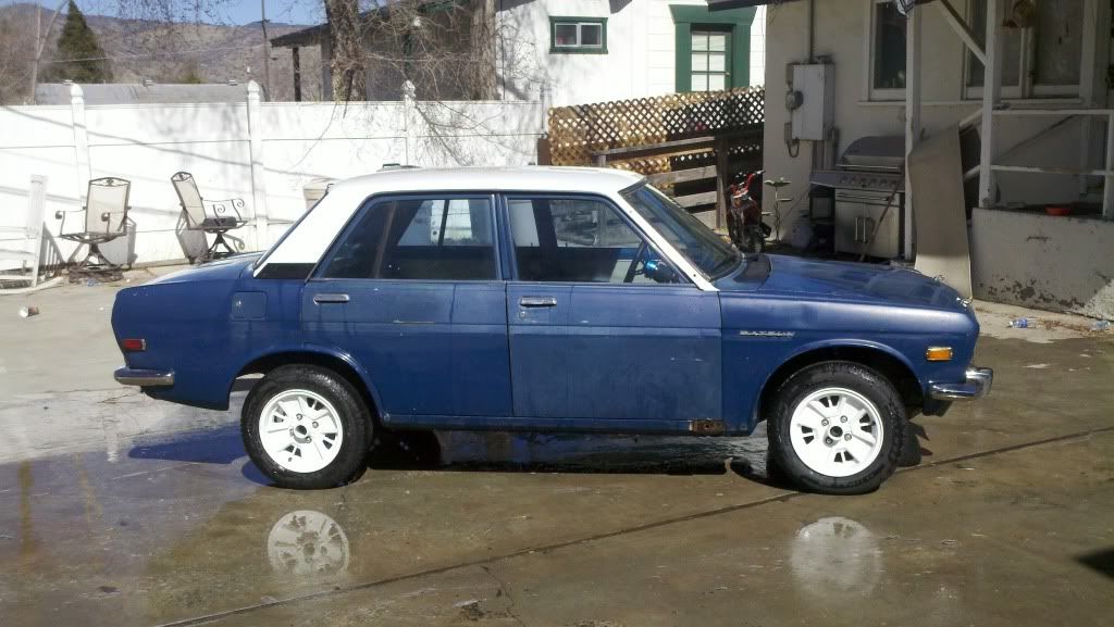

Re: Hydraulic hand brake bleeding
February 29, 2012 07:59PM
Here she is resting on the ground now if DMV can get there head out of there a.... I could take her out for a spin " legally ".
February 29, 2012 08:27PM
Really hard not to like 510's.....
