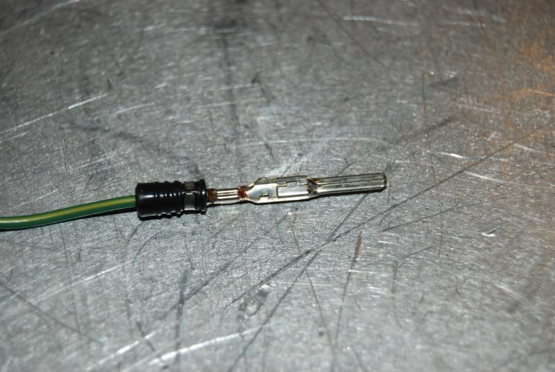

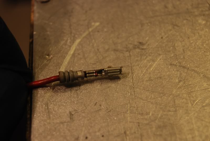

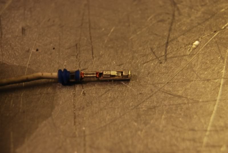

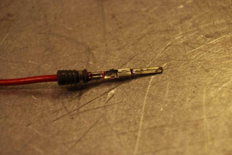

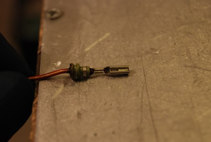

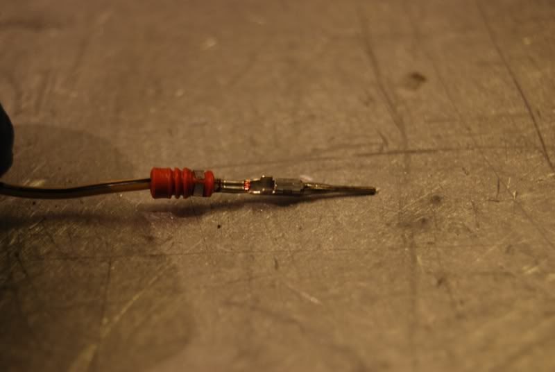

Thanks everyone for posting, Im pretty sure I made a mistake and the connectors are not Deutsch! This might be a good thing, but now I have to figure out what they really are. Here are the pins from a sortment of connectors. I think they are Metri Pack connectors? 280/480/630
Re: deutsch connectors Nope now what are they?
October 04, 2011 08:38AM
Not Deutsch. Metri-pac I think.
October 04, 2011 09:54AM
#3 and #6 look exactly like the Honda pins I just ordered for late model Honda shells. Can you post a picture of the shells?
