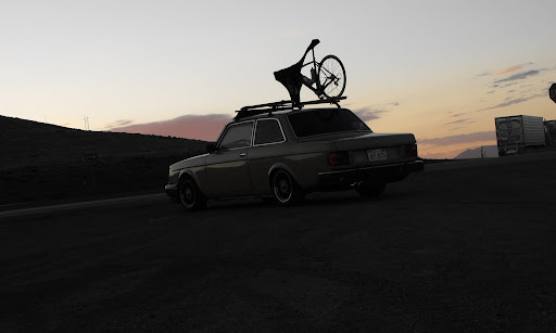

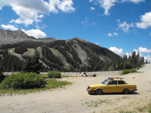

you know, just straight Pimpin in my VOLVO!

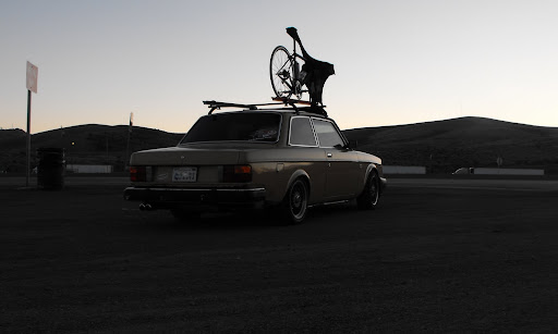

As for the trip...she didn't die but altitude deffinetly took it's toll on the fuel injection system...glad to be at sea level! Sorry I haven't checked in so long, this trip has kept me busy with a lot and haven't really made time for the forum life.
The loose ball joint was driving me nuts, but now that I'm back, got the tie rods, tie rod ends and ball joints replaced...gotta get it in for a toe adjust now, but feels a lot better already! When I've got some time, I'm going to get a set of control arms and trailing arms, so I can box them and insert the poly bushings and just swap them over to Honey-D!
now, for some CO pics!
As for my love of the car...couldn't be any better! Not really interested in selling it, but someone came into my shoppe this past weekend and asked if I was interested in selling it, so I figured I'd see if someone wants to give a ridiculious sum...figure the suspension, wheels and tyres are worth about $3,000, so what's another $2,000-$3,000 for a clean, well maintained 242? Again, don't really want to sell it but I'd be a fool not to take $5,000-$6,000 for it. Hands down, the best handling car I've driven!
Feels good to be back, but Colorado was a BLAST!
