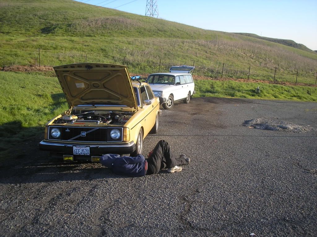

Made it as far as American Canyon Road.

Removing the GT air dam before the flat bed tow truck arrives.

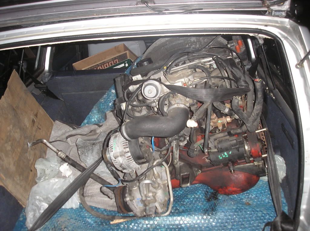

Compression in the skinny rod 745 B230FT is 120 psi and there is oil in the coolant overflow bottle.
The afternoon is spent in search of the elusive 93 + B 230 FT turbo engine.

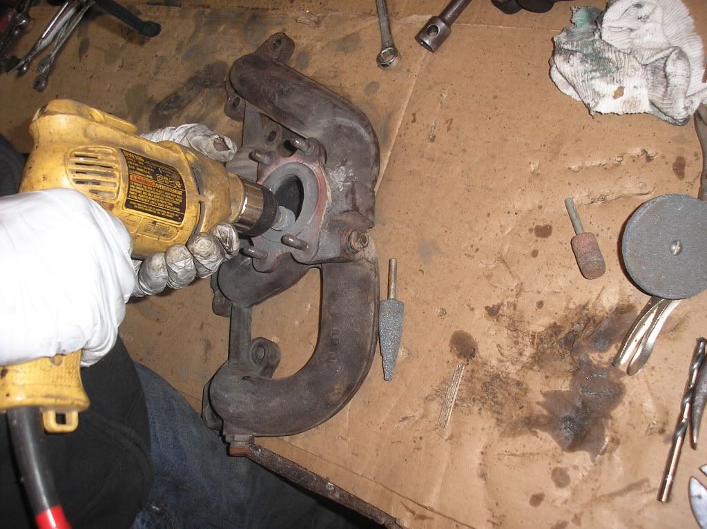

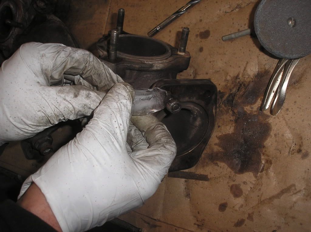

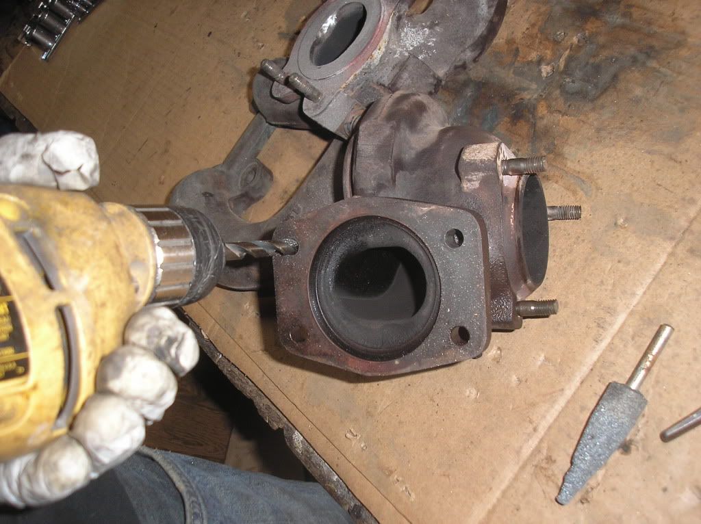

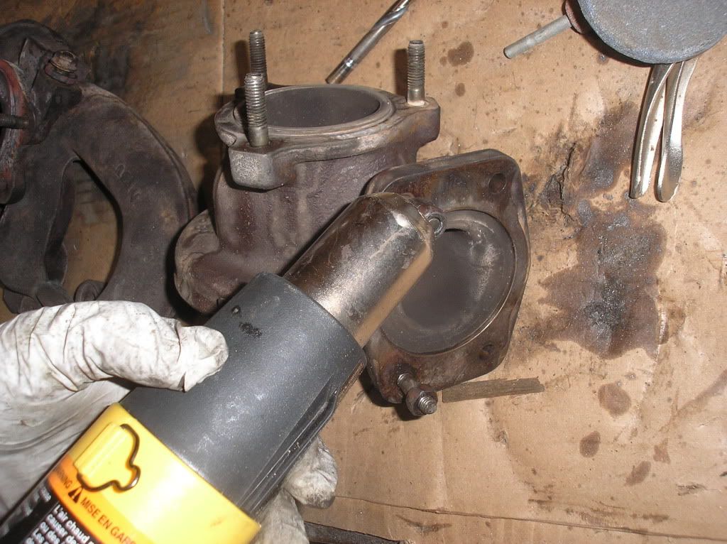

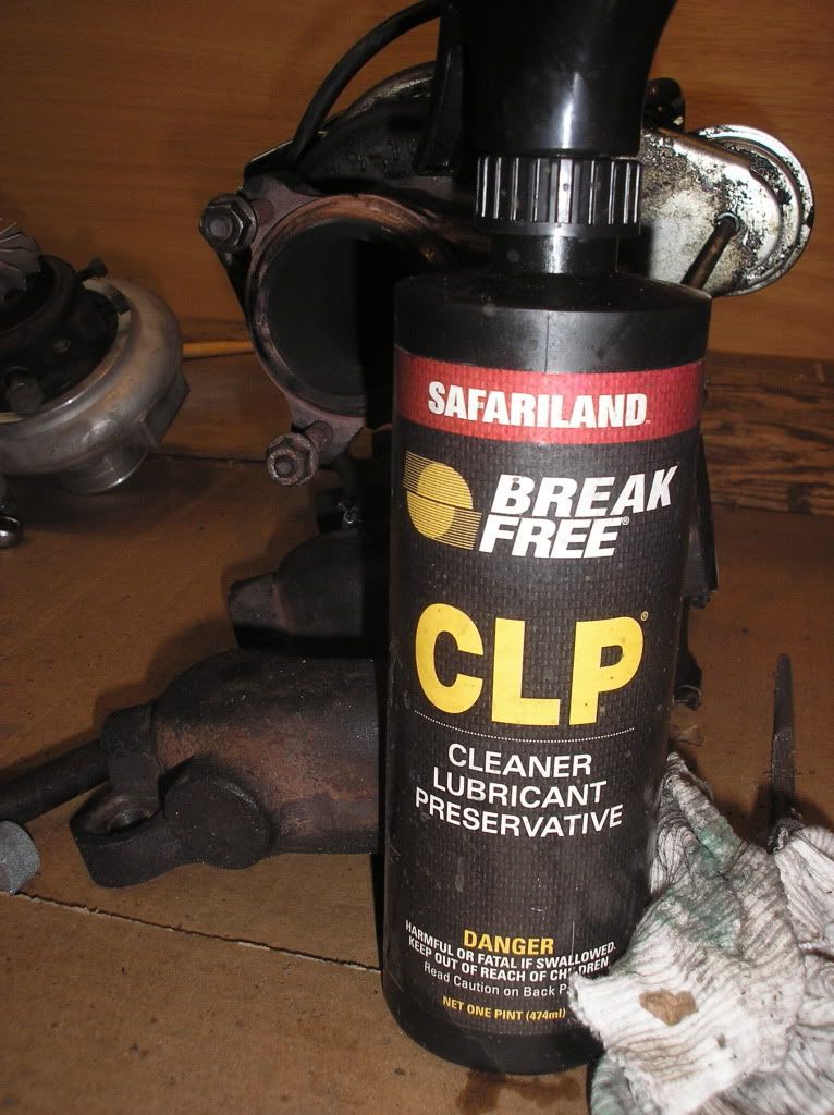

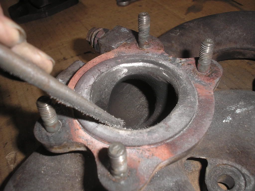

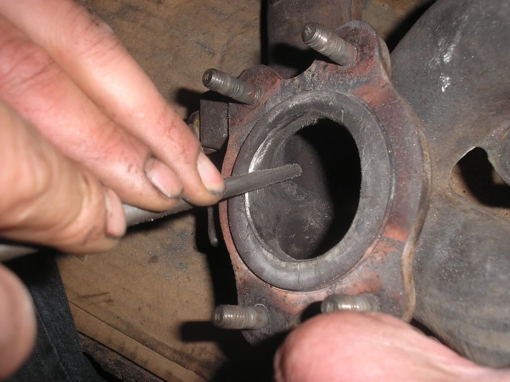

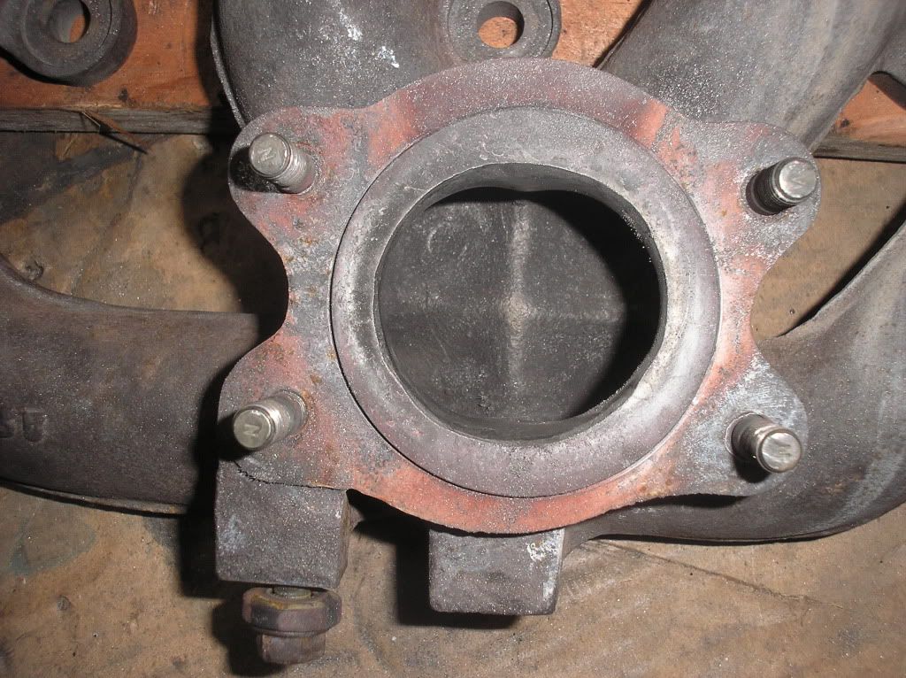

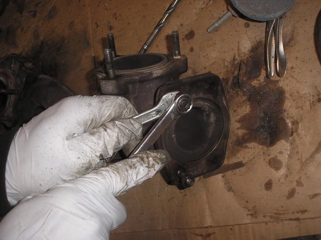

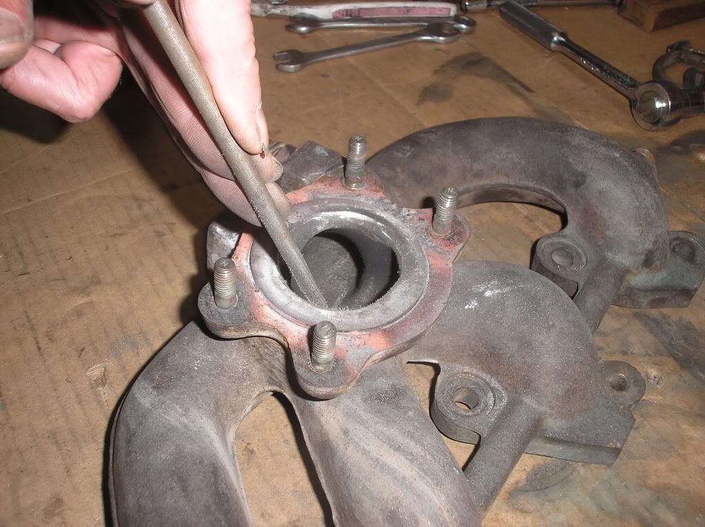

The secret sauce.
Get It Hot.
Shrink it and temper it.
Crack It Yes It Moves.!
Drill it at 600 rpm with the secret sauce.
Port it.
Then File It.
Work the inside transitions.
Round the corner a bit.
And there it be.
Edited 1 time(s). Last edit at 10/30/2011 02:26AM by Mylesofsmyles.

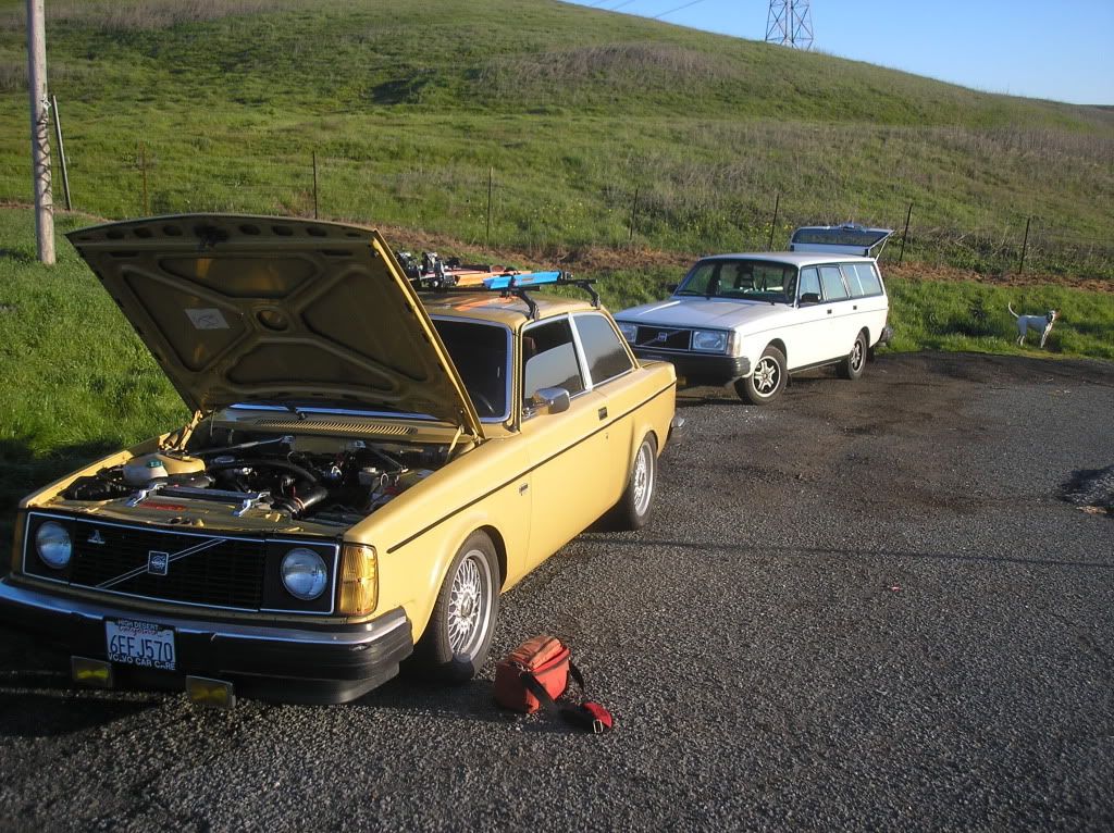

Damn...Shot Down @ Redwood's/
Was on my way to a lil Kegger in The City, when my alternator tensioner bolt snapped in half, leaving the belts squealing and the battery uncharged. Limped her to Redwoods to see just how bad it was.
Pics to follow, but we got the other half of the bolt out of the block, in no time...mended the tensioner and pressed the bushing back in properly and got her back together. Now the Bosch 100 alternator makes good power...holding a steady 12+ v when running.
Missed the party, so I was sober enough to drive home and had a lil fun in the park...
