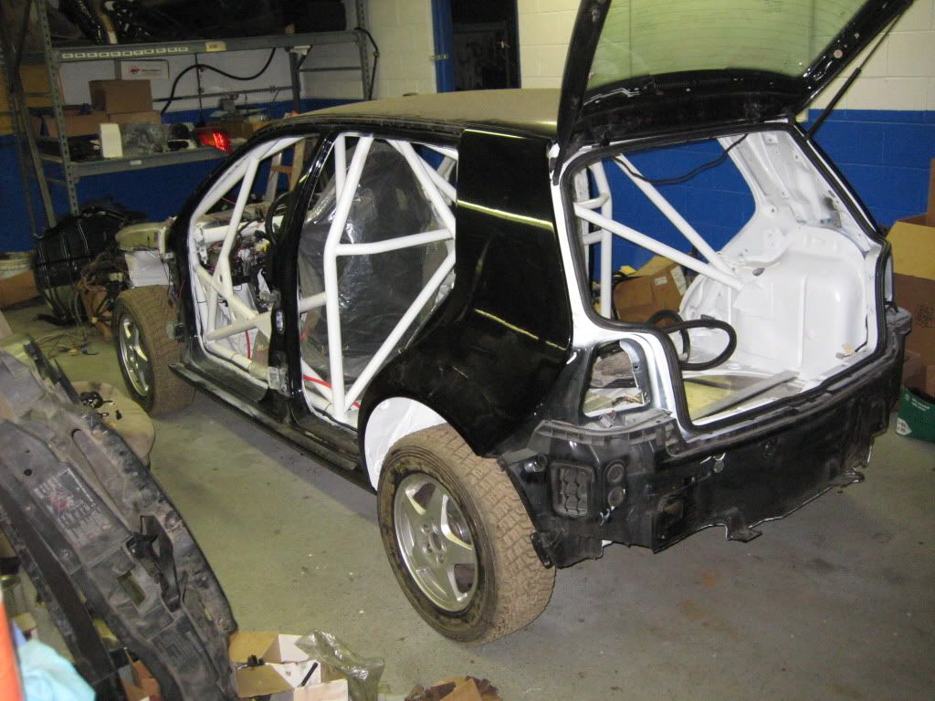

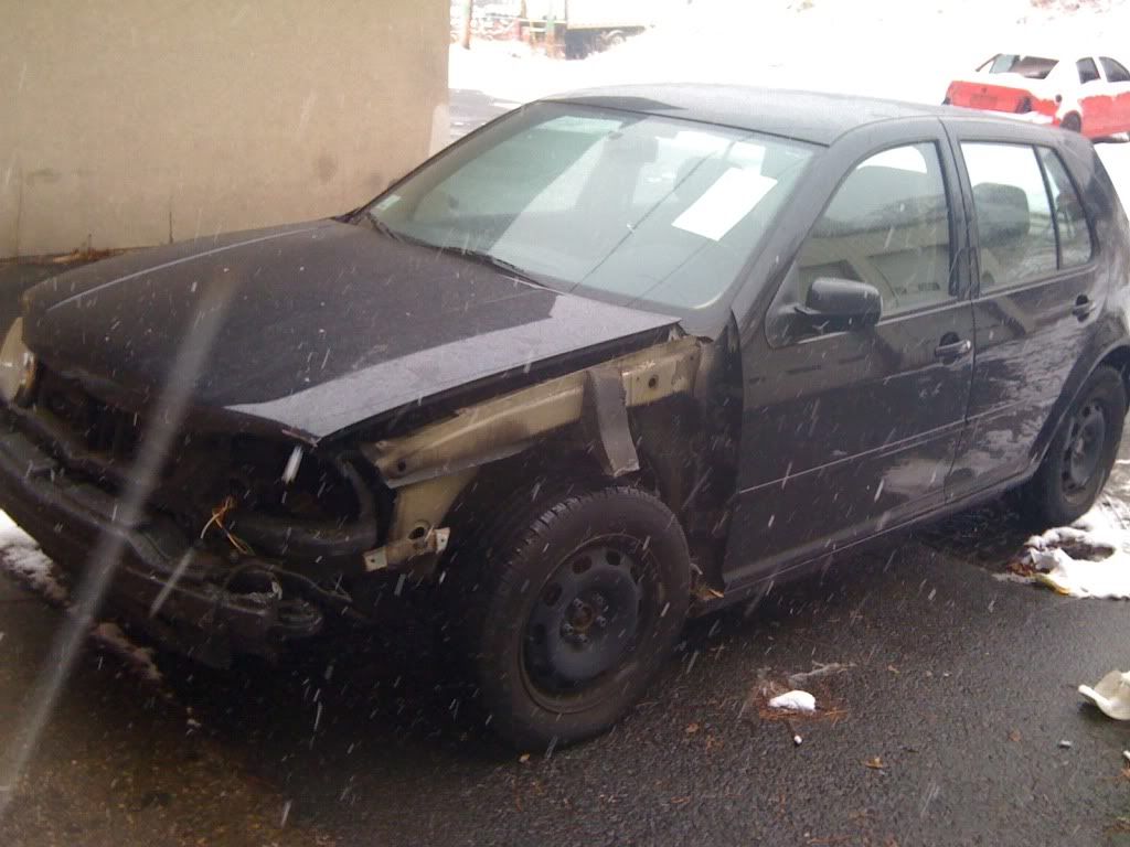

I started a build thread a while ago on Special stage but I figured it would be a good idea to throw one up here. This project has been a couple of year in the making now since I've had to spend most of my spare effort keeping my MK1 stage ready but after a lot of procrastinating, I've finally got some momentum going.
The car started off as a front corner fender bender that my friend's insurance company wrote off so I was able to pick it up for cheap. I stripped everything down at the beginning of 2010 and sent the shell off to Bill Doyle at www.cagethis.com for a cage then it spent most of the following year sitting on a rotisserie while I scrounged up parts and procrastinated about the sequence of the build. Now that the East coast season is over for a few months I've been able to get some paint on and started putting things together. If I can maintain my momentum I hope to have a log book in the next few months.

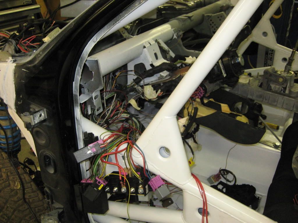

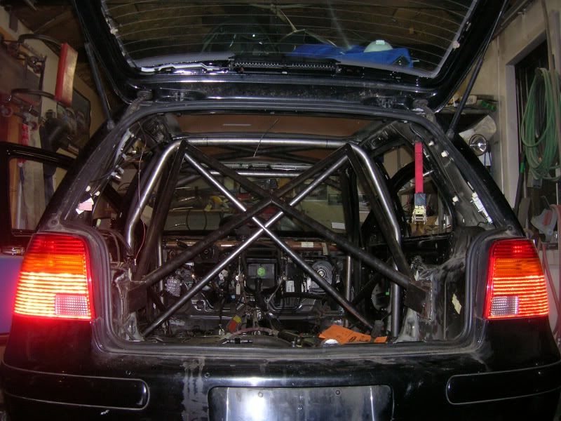

Is that a legal way to do the A-pillar support bars? I thought those had to connect all the way down to the floor and tie in where the sill bar an A-pillar bar intersect?
Huh?
Those intersect at through the door bar and continues down. Look closer...

Look even closer and notice you are looking at the tube behind the real A pillar that is up forward more.

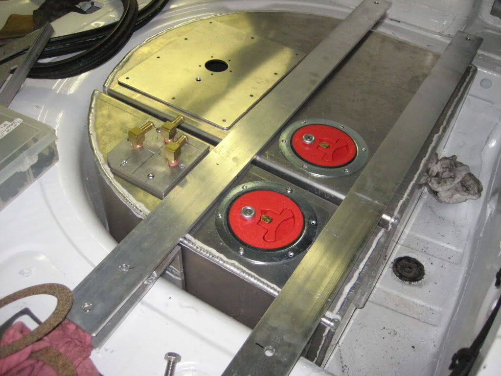

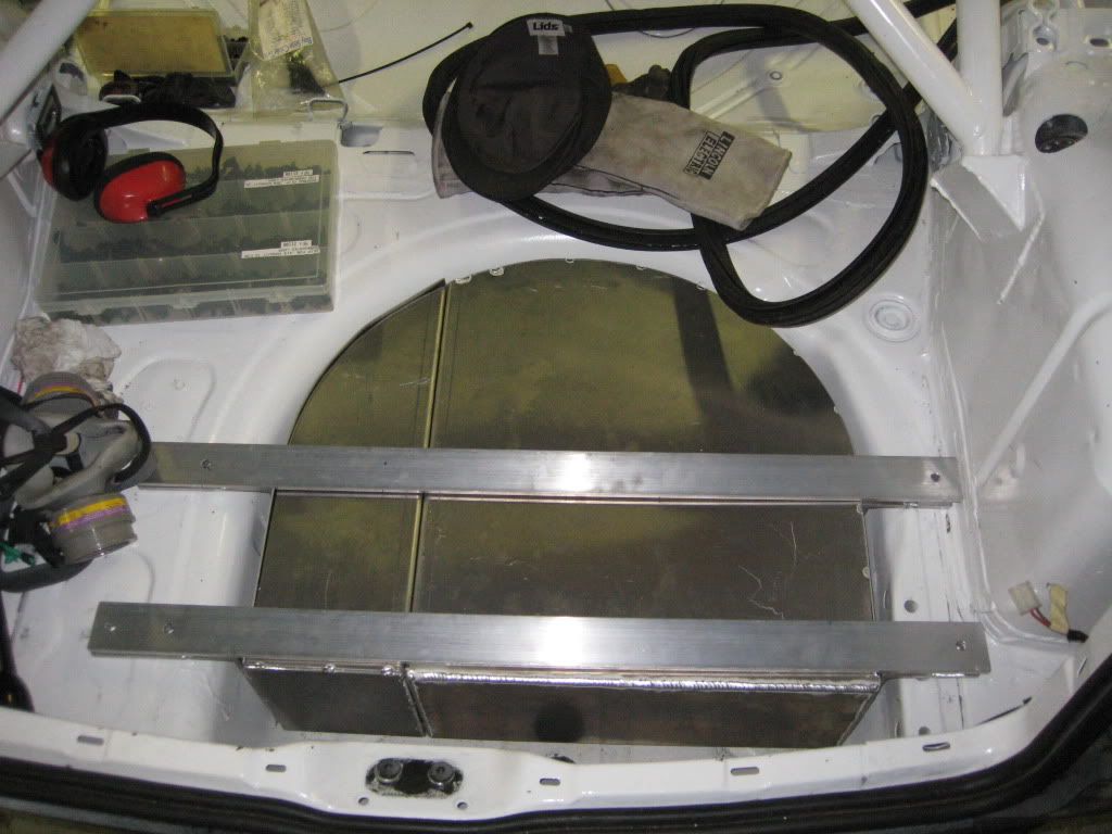

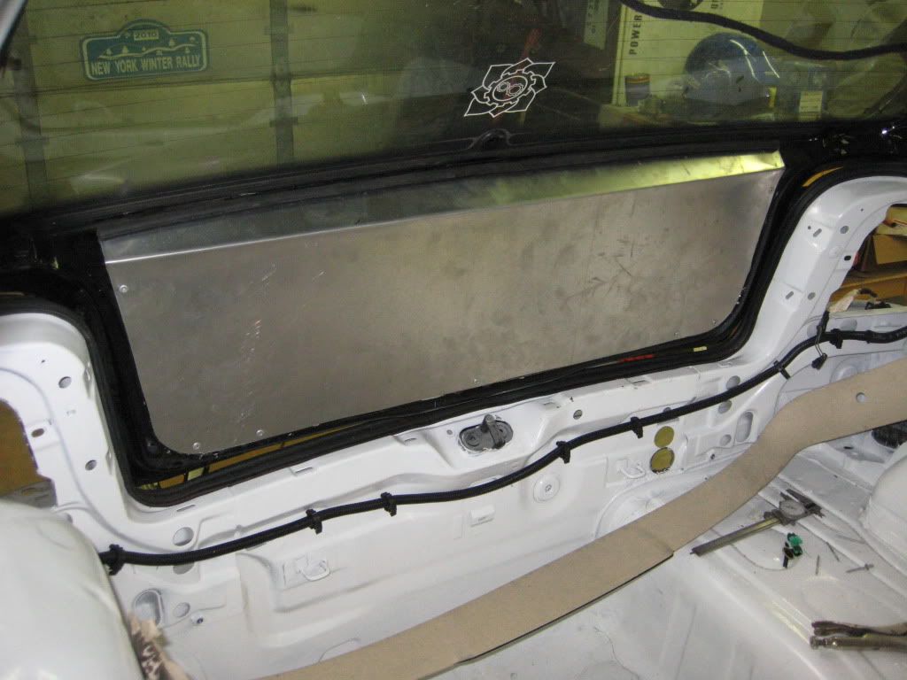

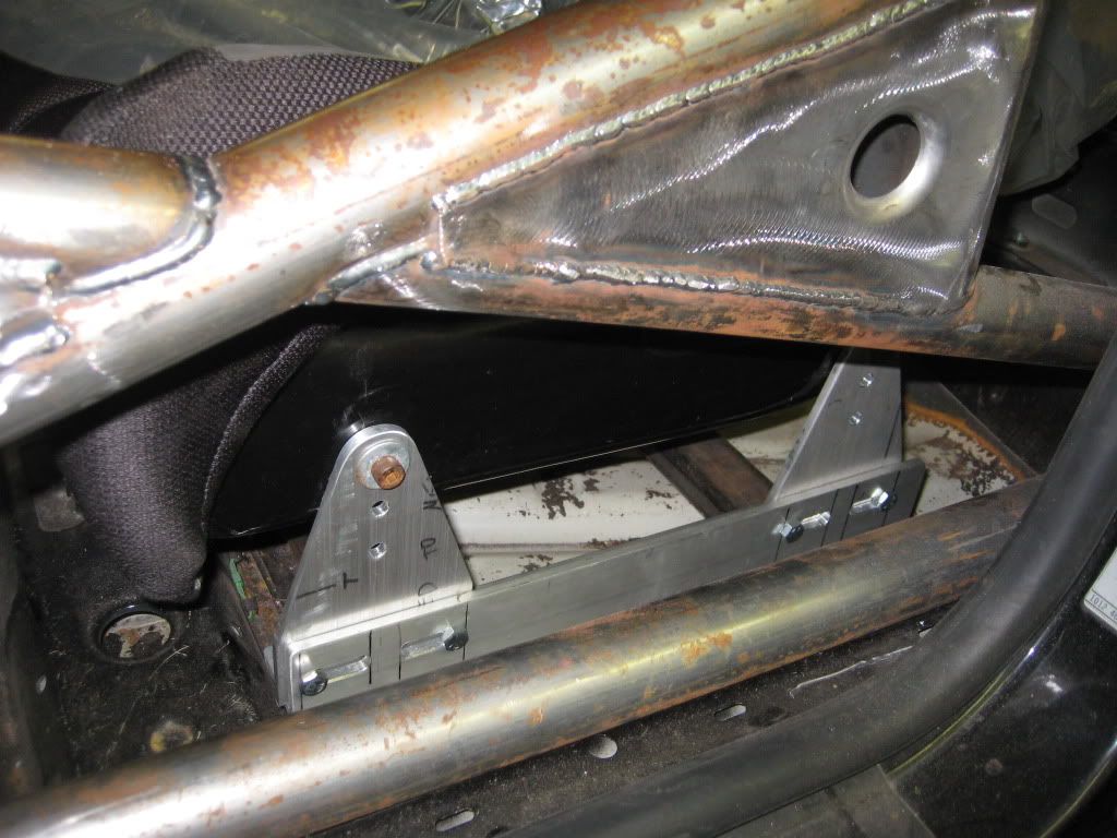

I fabbed up a pair of fuel cells a couple of weeks ago for the tire well. The smaller tank is the diesel start up tank and the larger will be for vegetable oil. I left a bit of room for storing spare motor oil etc.
I plan on getting the drivetrain in later this week.

very nice. I hope the lack of a FT3 and FIA sticker doesn't torpedo this...
And he will still need a cover over the fillers or the car will explode the instant he turns the key.
