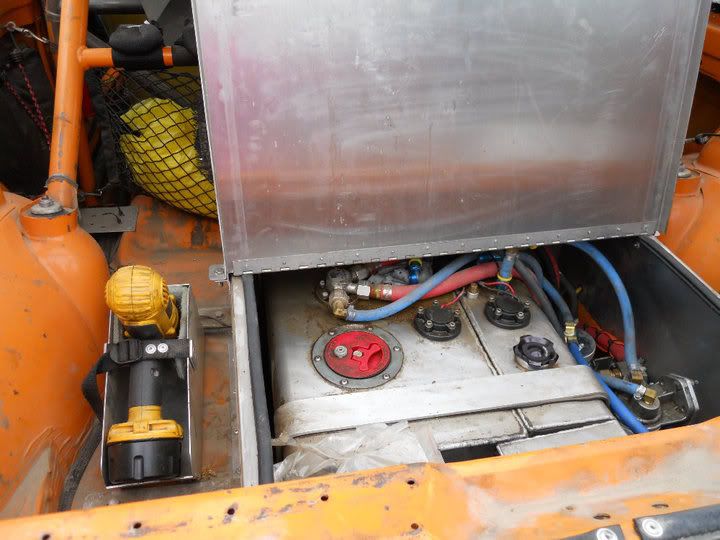

I have clearence from Mike Hurst on the tank design, I'm basically doing the same thing as I did on my current car, it will include a fire box. Vegetable oil and diesel are not nearly as volitile as gasoline but I don't mind having an extra enclosure in case of roll over etc..

I have seen folks run a coolant line from the engine through a heat exchanger in the veggie oil tank. Startup with diesel, get it warm then swtich over, then switch back prior to shut down. Kind of a PITA.

Not much of a "PITA", just the push of a button.
The tank, fuel filter and lines are heated with engine coolant. The engine cold starts on the smaller diesel tank then off you go. When the engine is up to normal operating temp and the vegetable oil is warm, the system controller switches a pair of solenoids and you're running on vegetable oil. At the end of the day (or if you're shutting down for long enough that the engine will cool down, you press a button that flushes the injection system and puts you back to diesel (takes about 30 sec while your driving).
There's a general system diagram and more info HERE
And John's right, it takes a lot of heat to get a grease fire going but once it's burning it needs to be smothered. Still, not as dramatic as a gasoline or race fuel fire.
