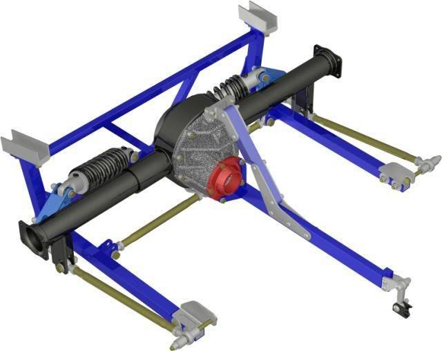

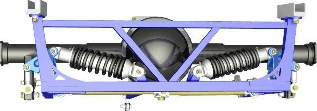

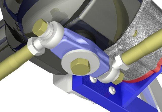

Just to throw it out there, I know of at least one application of a watts having the pivoting section horizontal instead of vertical, on the bottom of the diff. Needs Heim joints and probably not too applicable for rally, but it's at least possible.
SteveL
Steve Leitch
Join Date: 01/25/2009
Can't decide which to use...
Re: Basic measurements for them fancy 4 links
March 11, 2012 12:24PM
The outfit that designed this (2 brothers out of SoCal) for early Mustangs...
Not much good for Rally, but could be killer on tarmac ...
