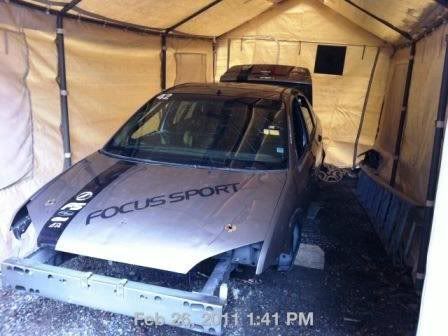

The ST was gutted and decided to go for rally instead.
I recently got around to putting the car together by using a donor 04 SVT Focus. So it currently has the SVT front and rear brake setup, sub-frames, and steering rack.

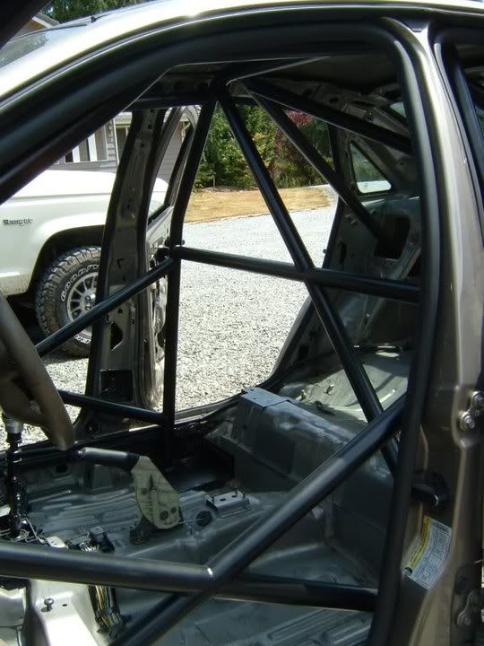

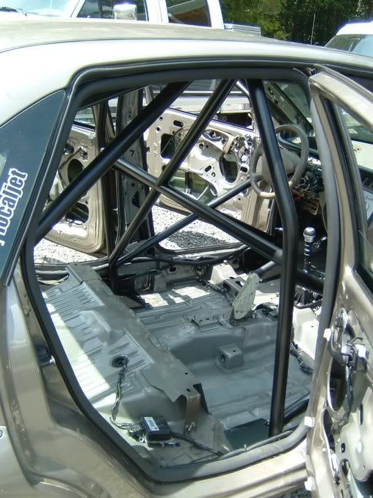

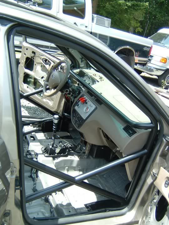

My issue: It looks like my roll cage has been built only for track and wont meet requirements for the rally scene. I know it can be modified to work, however I am running low on funds at the moment and dont have a pipe bender.

BEFORE WE SAY ANYMORE: what is the tube OD and wall thickness?
Mike doesn't look like you need a bender much (roof bars is about it) but you'll need to move and add some straight tubes.
I could show you how to save some of this IF THE TUBE OD and WALL is OK.
