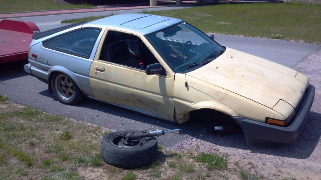

I had those bolts come loose on my corolla once, it didn't end that badly for me but broken steering components can be scary.
