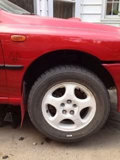

Also wanted to post a picture of them on a GC body since I have yet to find one on the interweb.
Here is a pic of said front strut at full droop. Thoughts/concerns?
