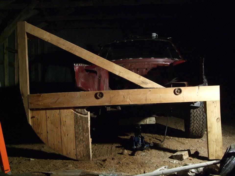

Hey guys... I stumbled upon this the other day when I was searching to find some rotisserie plans, seemed very cool how simple it was at first, but has anyone tried this before? Just looking for some input before I have my car fall onto its side while not even being in a ditch...

Yeah, I built a tip-tisserie from those plans for my VW.
With the cage in, it's a bit much for one person to tip up, but it worked great to tip it and strip the underbody, seam weld, and weld backing plates for the harnesses.
After I built it, I cut some off the tops of the side rests to get it a bit more angled, just to make sure it didn't fall back over.

I'm working on it. I havnt gotten to the tipping over part yet.

Carl, you might want to move your rotation closer to the centerline of the car...that far over is going to take a lot of effort to get it off the ground.

We've used 2 harbor freight engine stands with an extra foot or so welded in. Def need a few people around when the car gets rotated, but once in place, seemed reasonably stable.
We found this method to be about 1/2" too short for the hatchback compact (scratched up the back edge of the roof a bit), but for traditional cars with a trunk, it'd probably be just fine.

Funny thing, that thread was started by me. But I ended up just building my own. Bit over $100 in steel and I could do 100% rotation of the car with full adjustment's available for any other car I could want to put on it.
I havnt gotten that far yet, progress has kind of halted for the last month since the new little one got here. But, since I'm working on a dirt floor I could always dig down so that it rolls downhill when I go to flip it up.
