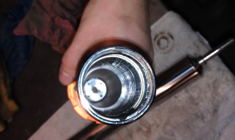

Hey all, Our Customer and friend brought in the rear Coilovers from his GC Impreza Rallycross/future stage rally car, so I could show him how to re-grease them. I took a few pictures and measurements so RallyAnarchy could pick them apart.
The Insert:
-45mm OD
-7" travel without springs or bump stops
-22.5" total length
-12mmx1.25 pin on the top w/internal hex
-10x1.25 bottom has adjuster so no slot or hex, but the bottom hole in the tube isn't threaded so...
The Tube:
-.700" wide solid bushing upper and lower 2.5" void between the two
- The seal was pretty lousy, solid rubber almost like and O-ring
- Fully threaded for use with height adjustable Ears
Overall:
-2.5" of stiff bump stop inside
-265lbs/in springs didn't measure the length but I think they were only 8" long (explains the bump stops)
-The ears would need to be re-inforced to have a chance on stage (easy enough fix)
-they come with tops that don't look like they'd make it, they have a roller bearing in the rear?
-the hardware and finish look good

45mm is a convenient size to make this tool for re-greasing:
greased up:
I've always been curious what the pros/cons to different thickness grease' are, John told me to use CV joint grease, is that just because it's easier to put in?

The grease tool worked really well and only took 15 mins to make because 45mm is about .020" bigger than 1.75".
I have a lot of scrap 1.75" tubing laying around, so I cut a chunk the total length from the top of the top bushing to the bottom of lower bushing beveled the ends, the bushings are 3/4" wide so I drilled a 3/16" hole 1" from the top rotated 180* and drilled another 3/16" hole 1" from the bottom.
I had some metric grease zirc fittings so I drilled and tapped one hole to m6x1 and installed a 90* fitting facing the closest end and then ground off the bit that stuck out and deburred and cleaned the whole thing.
I was going to weld a grab handle on but the grease gun I used was new and gripped the zirc so well I just snapped it on pumped it until a little came out the bottom vent hole, the last picture is after I pulled the tool out, almost can't see the bushings, sure beats a shoehorn!
For a 40mm insert you'd need 1.555" OD tubing, there's no reason it couldn't be plastic...
