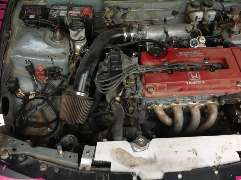

A bunch of events I've been to have had either water crossings or large puddles on the stages. Right now I know my car would just suck up water like crazy and I would like some suggestions on what to do. Below is what it currently looks like.

There's a lot you can do with that engine compartment, and keeping water out of that engine will be a worthy side benefit. First I would guess from drowning many jeeps, broncos, blazers and my rally car, that cars that don't run after the introduction of copious amounts of water, have wet electronics. quite often distributor/plugs/wires.
When you get the air filter WET, the engine stops. You water boarded the engine, it Won't breathe. I once thought I'd killed a $5000 motor by sucking water into it and bending/breaking everything. It flat wouldn't turn over. Pulled the soaked air filter and poof! Magic! all was well.
So back to the pic. That cold air intake is currently doing the exact opposite, its sucking in the hottest air it can find, right off that 450+ degree exhaust 8 inches to its right. For cone type filters to work, they need to be put in some enclosure. At very least, a baffle/heat shield to separate it from the engine. If you isolate it in the far corner, you can duct fresh, cold air to it and keep water out of it!

I think I'm just going to get a different intake tube that moves the filter closer to the fender then build a box to try block as much water as possible.

Dan, Mine is in that spot you are talking about, I have completely boxed it in, with a lid, and it draws through a hole in the side of the inner fender. I have full HDPE wheel house liners, so it stays pretty dry. At that Vancouver RX there were some very deep puddles, and the filter stayed pretty dry.

Both my cars have the stock airbox (slightly modified) about where your stock one apparently was. The frame rail protects it from direct splashes, but even so the water would have to get really lucky to get into the filter, and there're drain holes in it to let any that does get in there drip right back out. The in-fender snorkus has been removed, but I cover that hole with a plate made from HPDE. That prevents water coming in from the side.
The distributor on the 16v car is way up high and away so I don't really worry about it much. On the 8v it's in front of the engine and I just check regularly to make sure its O-ring is in good shape, and on both of them I grease the plug connections and make sure the boots fit tightly.
I don't think I've ever had problems with water splashes other than my front shocks getting hydrolocked at Olympus back in 2008.
I think your plan to move the intake over to the fender area and make a box for it is a good one.

I run a nylon sock over the K&N cone filter. With the engine running water will bead and run off the sock.

I was wondering about those. Thanks for the info. I think I'll build a box and get one of those.

Gotcha. I got an elbow to just move my filter over the frame rail then I'm going to do a nylon pre filter and make a box for the filter to sit in.
