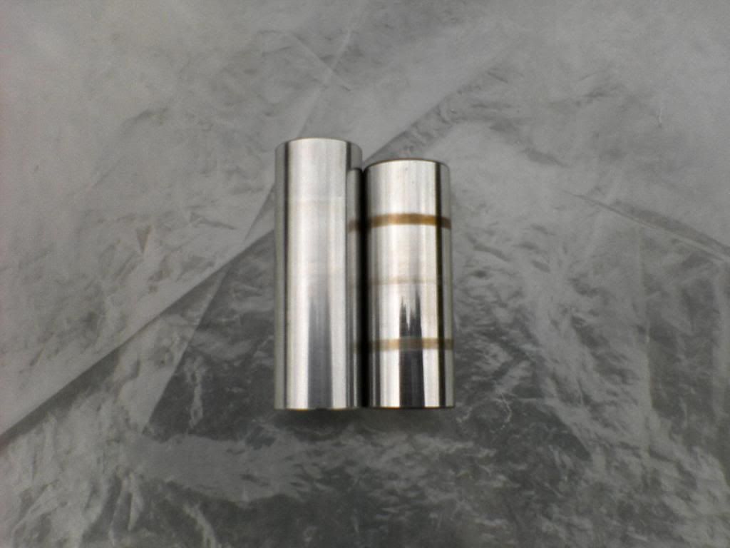

Jeepers, is that the time. It's taken 5 months to track down gudgeon pins!! At this rate of progress any potential increase in the performance from the engine will be negated by my failing reaction times and physical degeneration due to old age.
Anyway, check out the pins...
The keen eyed may notice that the pins I finally found were 4mm longer than what I need. However I felt far happier reducing the length of the longer lighter wall thickness pins rather than trying to bore the original heavy ones.

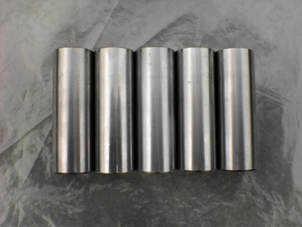

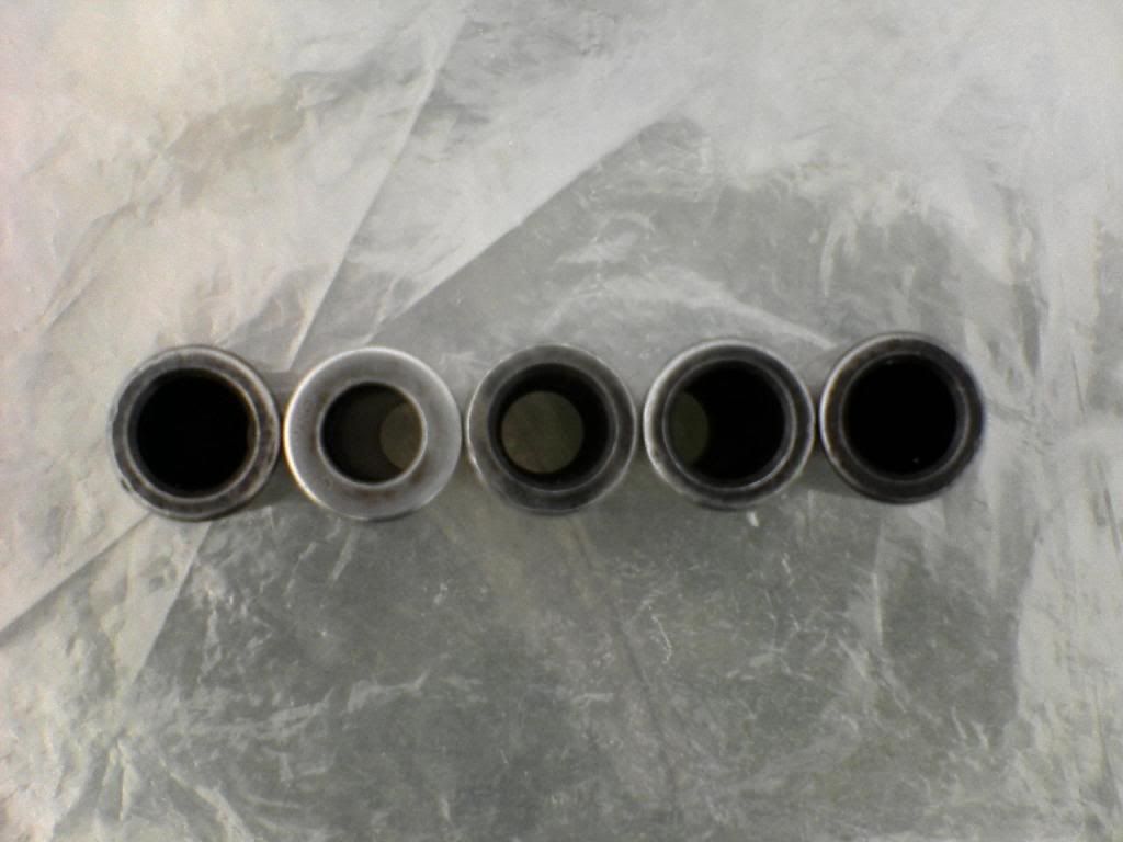

So here are the finished pins. There's 5 of them in the line up but who can spot the fat imposter?
Can't believe so many punters do the lottery but there were no takers here........It was free entry during these recession times, but as nobody answered no 2 I will just have to drink all the beer I had set aside for the winner myself. smileys with beer
