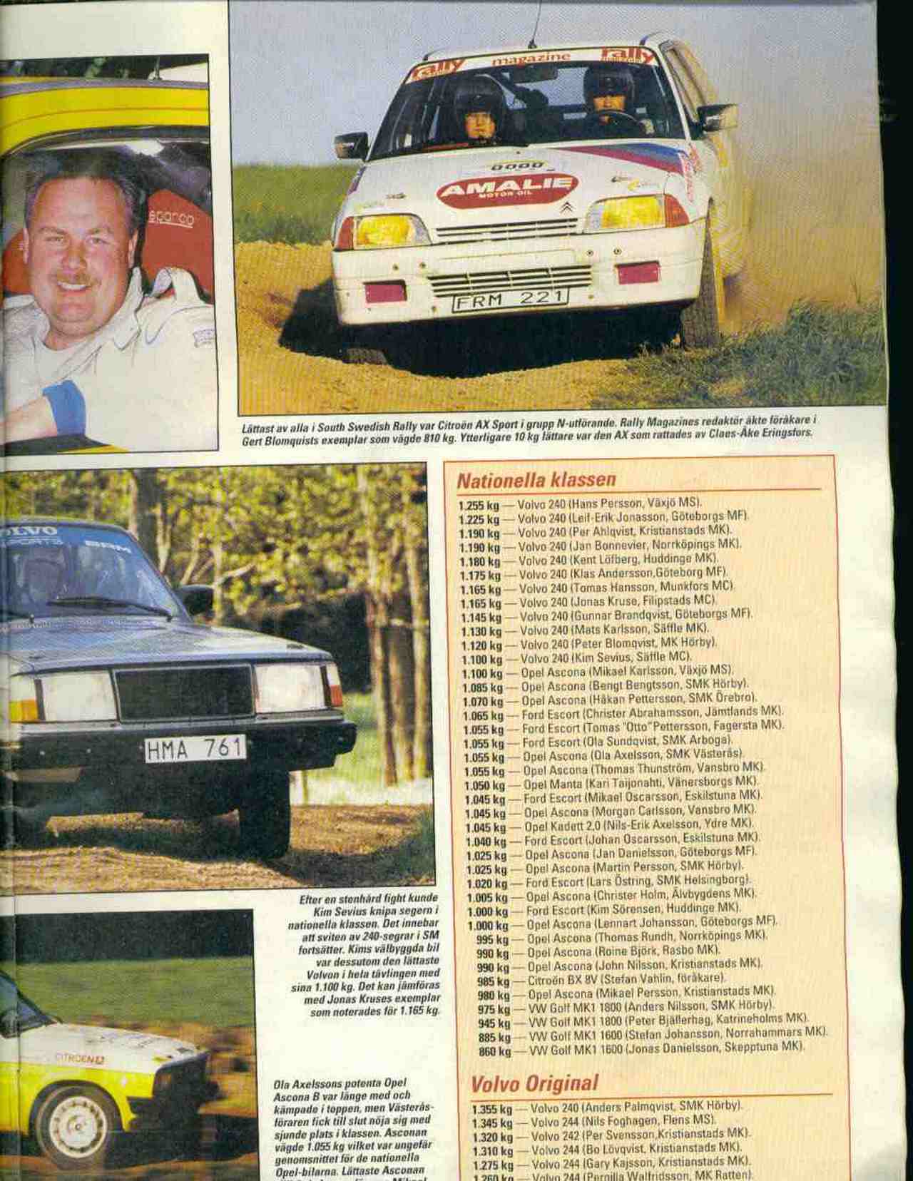

Maybe its best to see what actual rally cars weigh, so here's some official weights at a old Swedish Championship event: (kinda huge so the print is clear)
Just for comparison here's the other classes:
So we see a range of weights..
Lightest Escort is at 1000kg or 2200lbs, heaviest at 1065kg or 2343lbs
The then dominant car was the Ascona B--midway between Escort size (94.5" wheelbase) and 240 Volvo at 104" wheelbase...it was 99.1" wheelbase
So lightest Ascona was 980kg--and that has to be an Ascona A chassi---95.4" wheelbase...heaviest was 1100kg or 2420lbs... average about 1055kg aka 2321lbs
Lightest 240 was 1100kg or 242lbs and the heaviest was at 1255kg or 2761lbs
Average Escort.....1032kg or 2271.5 lbs
Average Volvo.......1170kg or 2575lbs
About 13.3% heavier

Thanks gents, appreciate it. The weight of the Escorts and Volvos are closer in that trim than I'd have expected, but maybe that's due to typical Yank "can't get it here - it must be awesome!" thinking.
*edit* And speaking of Yank-o-centric points of view, didn't realize the capability of the Opels. Interesting too that a lot of the top flight rally stuff back then were using wishbones instead of struts.

John, I just noticed that you got a list of weights for the volvo original stuff... whats the lightest one of those weighing in at?
In case your curious my car has nothing more than standard rally prep done for weight savings... no fiberglass panels, stock motor, stock cast iron brakes and an axle that adds around 20-30lbs. cage is all 1.75inch tubing. Even with the couple of extra tubes north american cages demand I see no reason why you couldnt get a 240 down well under 1200kg. Possibly touch the 1100kg mark but at that point some fiberglass panels would likely be involved.
