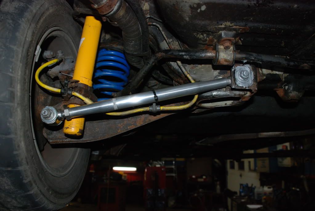

Somebody, looking at previous established, successful examples, looks at weight, and available travel---in your VW struts without spacers an available 188mm travel or about 7.5"----and thinks of similar applications having that travel and weight, and chooses a spring.
Then, looking previous examples, chooses a damper to control the spring.
Your car with conventional struts and conventional geometry, is easy in front.
It is the rear that is an especially difficult design to do something worthwhile.
I believe your rear stuff is more or less the same as the Suzuki MkI GTI from the 80s:
The "socket in" deal is always a bitch to deal with because of the size of the hole you must poke the suspension part--strut /shock/whatever into and the way it passes thru---and hangs way down.. The diameter is about 45mm.
Unfortunate in that suspension units worth considering tend to be 50mm OD...
And in real world examination shows that the material thickness of the pinchy part is thin, and would be "Way thin" if bored to 50--and that's ignoring the placement of the pinch bolt which "grazes" the side of the shock/strut..
Next: if the unit cannot pass thru and get pinched, logic says the strut/shock think must be above the knuckle---and this leaves insuffcient room for more than about a 4" travel unit---and I think we can all agree that 4" travel on a gravel car is just a tad short--by about 3-4"...
Add to that the spring being jammed between the lower arm and the body separate and difficult to give the spring more travel leads us pretty inevitably to a simple solution..something easy to make, and easy to install kinda of like this:
Which can be made tall enough that adequate travel AND A SPRING can be easily accommodated above the pinch point...
Then spring and damper choice is a snap.

I shaved the rear strut bodies down about 0.3mm to get them to fit in to the stock knuckles. I'm trying to stay in stock class for now (I know how much most people hate it), but maybe down the road I'll fabricate my own knuckles and weld the tower.
I've already been running on those rear shocks, so I'm not worried too much about fitment of the rears, and have the travel back there. My concern there is just with the rates for now as they're overdamped.

Rear is:
F4-V36-0066-H0 shaved bottom to fit in the stock collar moved the mounting tabs around a little bit so the shock is in the middle of travel at 0.5" above stock ride height. Shock travel (compressed bumpstops to full extension) is about 5.25" according to spec sheets (don't have actual measured values with me)
Revalved to 330/170
Right now, H&R lowering springs are on the car, in stock location. Not sure the rate, and they're progressive/have dead coils.
Re: Help with Spring Rates & Shock Rates?
July 31, 2013 03:55PM
ofensus
Rear is:
Revalved to 330/170
This?
