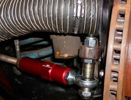

Shiiiirley using a rod end and stud and a proper spacer would be the best way to tackle the height of the outer tie rod joint.

open | download - rss_front_toe_steer_links.jpg (24.9 KB)

I did my changes in this order.
Lower front and pull forward front pivot (add anti dive and castor, known benefit from previous car)
Set adjustable strut tops in roughly same position as old car.
Test bump steer.
Lower rack mounts 10mm to hopefully correct issue. I knew which way to go but had no idea how to work out how far.
Rechecked and I'd fluked it first go.
I had planed to recheck it once final ride heights, damping, rebound, spring rates and alignments settings etc were worked out but it drove really well and my circumstances changed(eg had to buy my mates rallycar I crashed) so it was sold.
I keep in touch with new owners and they haven't changed any of the settings.
EDIT
if it did need any tweaking I would have changed the tierod ends to something like pictured above.
Edited 1 time(s). Last edit at 02/02/2014 04:17PM by buerckner.
