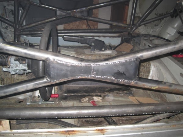

Door Gussets:
This was the method I used, probably better out there. ![]() So your material width is the green width. The material length is 1/2 the circumference of the tube you are gusseting plus double the yellow measure. Cut out the square sheet of steel ![]() Mark the center, align that 90 degrees to a scrap piece of tube the same size as what you are gusseting, and use two vice grips to lock it there ![]() Start bending by hand. Keep your hands close to the tube to get a smooth bend. This is a bit more than 1mm thick steel (so thick) and it bends pretty easily. ![]() ![]() ![]() You will want to over bend it, which will help hold it it on the tube when you are trying to tack it in place ![]() Because the bars I am doing are such a low angle, I wanted to make sure they were properly gusseted. So instead of measuring between the closest points, I measured from the tube centers. So the gusset is too far out. ![]() To fix this, I took the ends, and then notched them at 45degrees. I pre cut a tube to act as a template so I didn't ahve to mark this every time and cut them. ![]() Still a bit off. Start to take a bit off the 45 to get them closer. Be careful, a small amount off on this moves it in a LOT ![]() ![]() Mark your trimming. On a straight joint, take a straight edge and draw a line from the tube center to the joint center. For these since they are bent tubes that joined, I used my fingers on the TOP of the tube and then held the pen at a constant distance. as you move it down the tubes, it marks the center of the tube for you ![]() ![]() Cut along the lines and clean it up a bit with a grinder cutoff wheel. ![]() Clamp them on TIGHT. the less gaps the better. Tack then fully weld. I didn't do a great job on the welding on this one.. pretty uneven. Strong, but a bit ugly. I was having issues with the welder, and don't know why. I dont think it likes the hot rolled steel much. Could be the coating on it, since I didn;t take it off completely. ![]() ![]() |

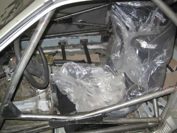

So, drivers side, I inlet the floor for the seat mounts, because I am tall so I'd like some headroom. On the passenger side, I decided to take a different route and did FIA 35mm square tube mounts that are more normal. (well mine are 1 1/2" since getting 35mm tube here is impossible.
I missed some pictures on this that didn't save into my camera, but the ends of tunnel side tudes are inlet into the tunnel so that I can put in the inserts very close to the tunnel. So without further ado: Sill side front mount, this is missing the bolts. The bars will be removable. ![]() Tunnel side front mount ![]() Measuring back for back mount with my high tech measuring stick: ![]() I ended up measuring the centers on the seat mounts to see how far apart the bars need to be. To find hole center to hole center. Measure from the close side of the hole to the far side of the hole, and that is your center ![]() ![]() All Marked up: ![]() A box all bent up to be welded in... I did weld it in, but it ended up being crappy, so I cut it out: ![]() |
MattWatson Matt Watson Super Moderator Location: Calgary Join Date: 04/17/2013 Age: Midlife Crisis Posts: 151 Rally Car: Merkur |
So a couple pictures need to be posted at least every day... so look its a seat in a car:
![]() I sat in it, decided how far back it needed to be and then marked the front holes. I'll mark and drill the backs afterwards based on measures instead of tracing: ![]() Mocking up the shoulder straps to make sure they would reach the back harness bar and I didn't have to put something closer. They are all good to wrap around the bar. ![]() ![]() When the seat was bolted in with the front two holes, I marked all the harness openings to try to figure out where I am going to mount the plates: ![]() ![]() Kinda where the plate is going, just on the other side of the body. The idea is that if the harness pulls that it will have to pull the plate through the floor... and if that happens then well... there's bigger things to worry about. ![]() |
